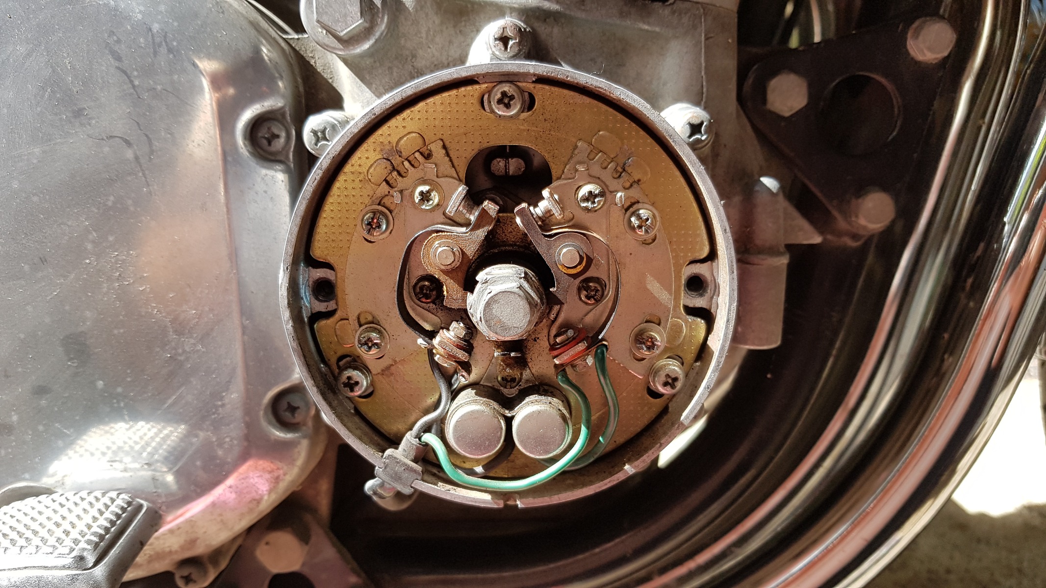

I have a couple of stripped screws and some that are seized, as well as fairly pitted points. My 2,3 points slip and close the gap every 500kms or so and one of the screws turns freely. In looking for parts, I find that quite a few are no longer available. I did find and entire breaker plate with all of the parts, including the plates, points and condensers. I've ordered the whole plate (part 3 here:
www.partzilla.com/catalog/kawasaki/motor...r-rectifier-77-78-a1
) Should it just be a case of lining up the timing cam, removing the 3 screws, lock washers and washers at 12 o'clock, 4 o'clock and 8 o'clock, undoing the condenser wires and sliding the whole plate off, then sliding the new one on? I realize I'll have to gap the points and set the timing, but are there any hidden issues I should be aware of?

If you're replacing the whole thing you may not need to touch anything other than the three screws. FYI, when you order from Partzilla you are getting OEM parts. I believe they simply order from Kawasaki and when they get the parts they send them to you.

24 Jun 2019 17:07 - 24 Jun 2019 17:08hardrockminer wrote: If you're replacing the whole thing you may not need to touch anything other than the three screws. FYI, when you order from Partzilla you are getting OEM parts. I believe they simply order from Kawasaki and when they get the parts they send them to you.
I actually ordered directly from the Kawasaki dealer in Cranbrook. By the time shipping and exchange are factored in, it's almost the same price. I linked to Partzilla just for the diagram.
