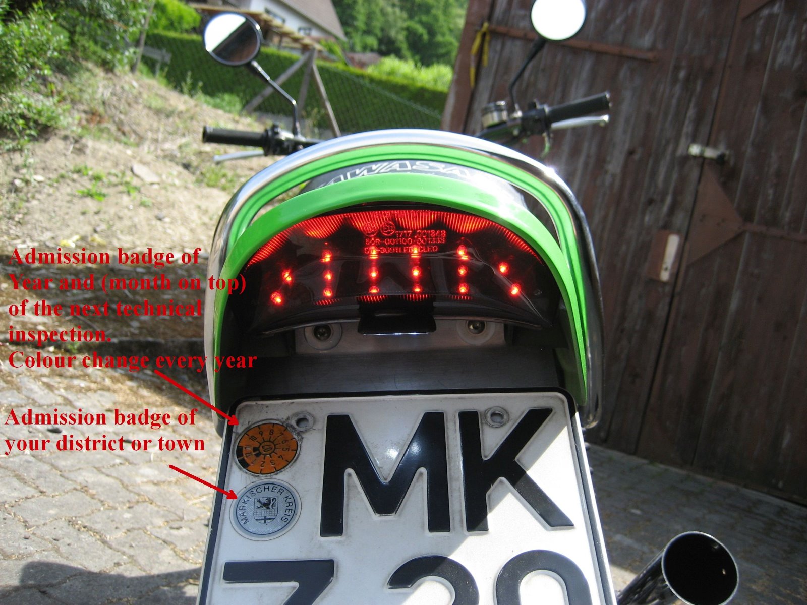

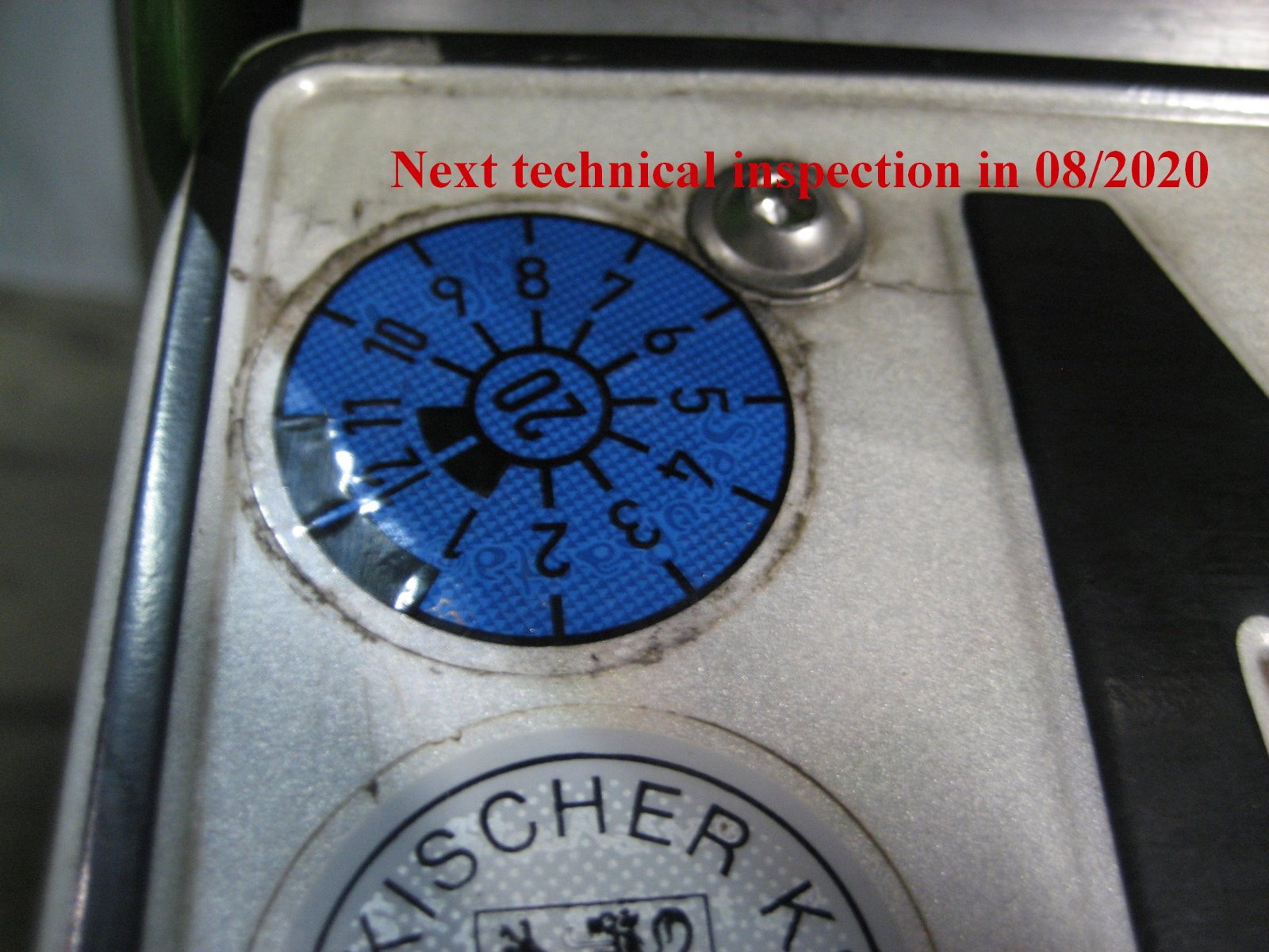

What meaning do the tags or decals have on your registration plates?
Technical inspection every two years
