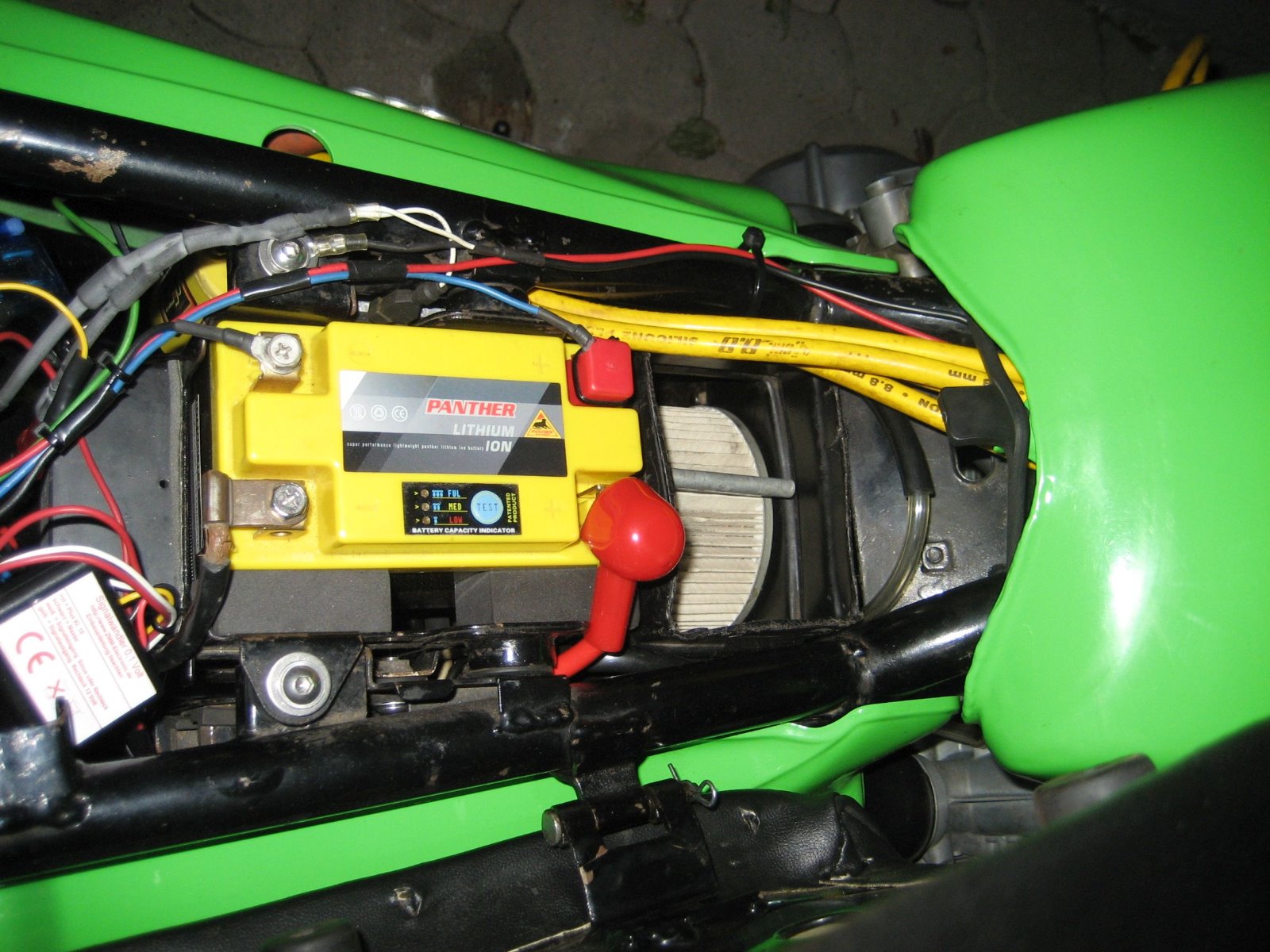

The LiFe-Po battery i bought for 100 Euros is in use on stock Regulator and starting my bike so easy.
Stock battery = 4,90 Kg
LiFe-Po battery = 0,90 Kg
any questions???

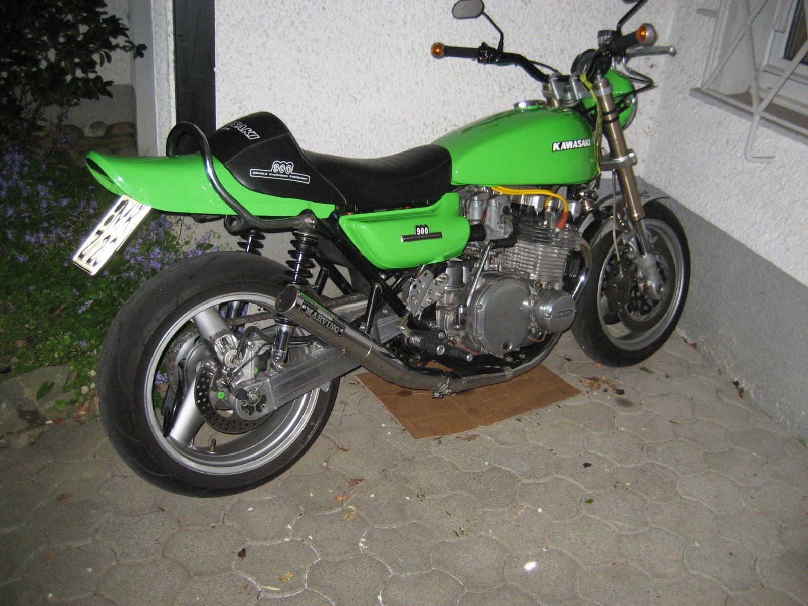

Great looking bike Scirocco! But could the registration plate be any bigger? I would be afraid wind lift would take effect and raise the back of the bike at speed....LOL!

It´s the minimum size for a german motorcycle licence plate 200 x 200 cm in the mid 90th.
Today the minimum size is 180 x 200 cm!!! what a Progress!!!
