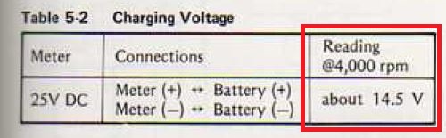

28 May 2019 08:11 - 28 May 2019 08:15Robb2018 wrote: ............... The manual states normal charging voltage at 4 grand should be between 15 and 20 volts. ...............
Holy cow! What manual says that? Below is a clip from the 1981 KZ650 Kawasaki Service Manual. Ed

That's with the regulator unplugged.

Thanks, I missed that part. The good news, Z1 Parts is sending me a new RR on warranty. Great people over there.
So obviously this test is meant to be done if you have a separate regulator and rectifier.
