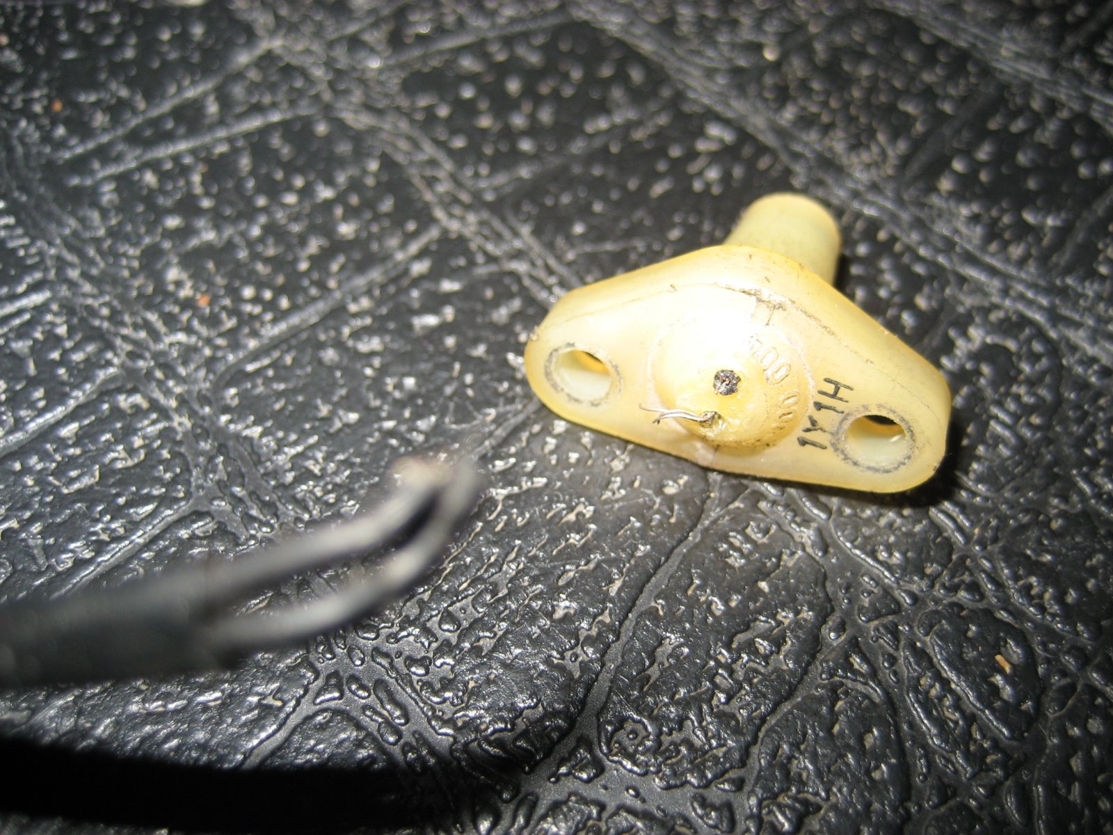

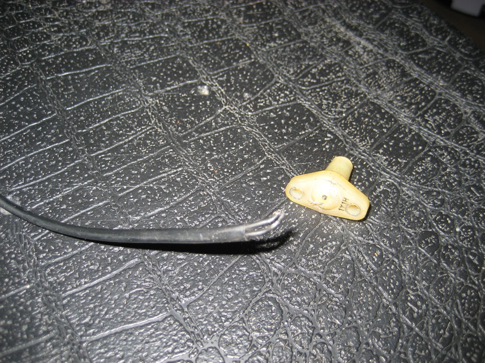

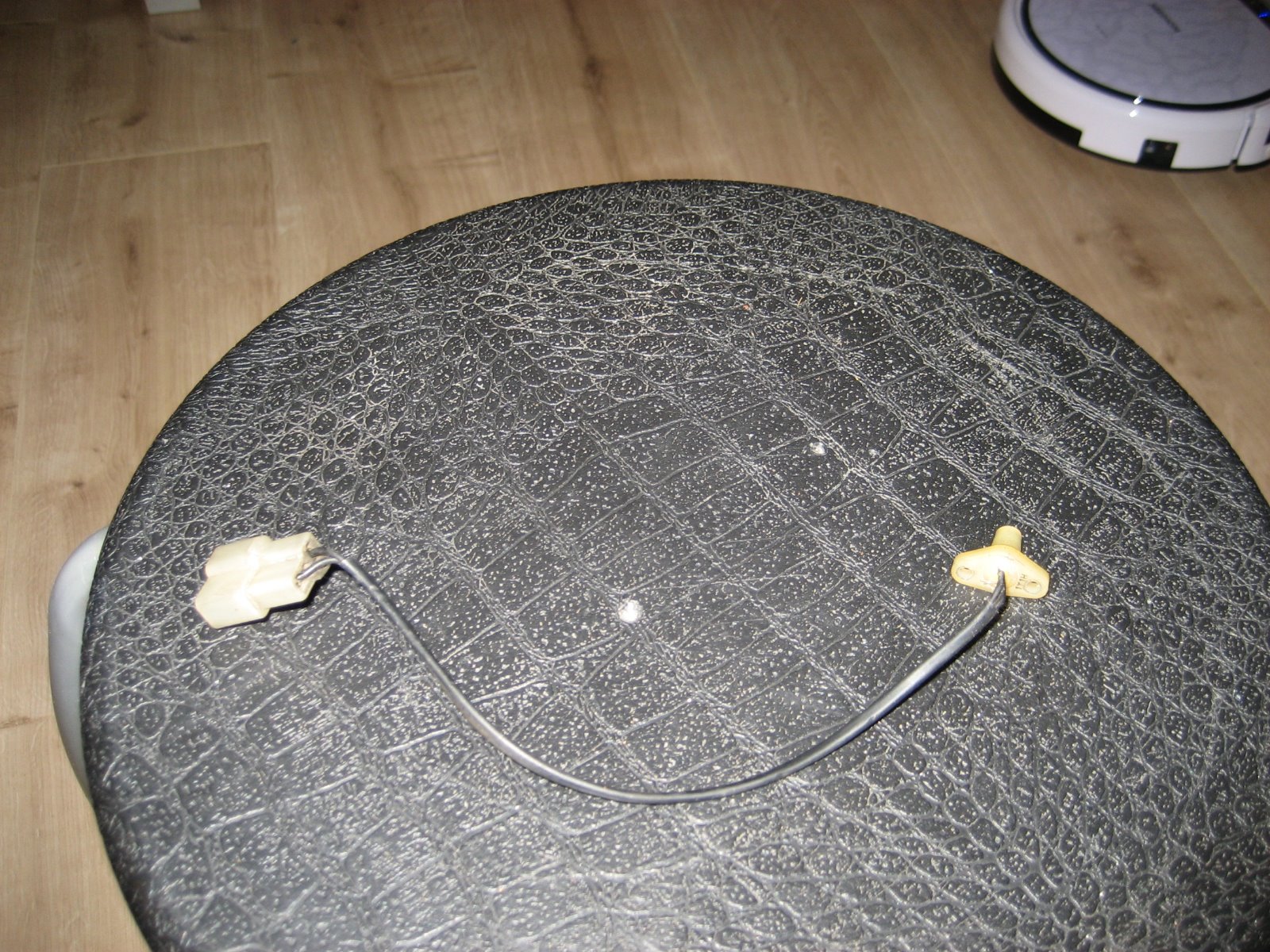

I need a new/used air temperature air sensor for ZX1100 KZ1100 ZN1300 GPZ 1100 UT
The wiring get apart during the cleaning of the air box.
Have try to extract the Thermistor but all is glued in epoxy.

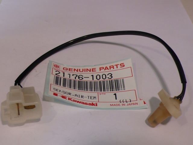

This is the one I was told will work in place of OEM>>>
www.eeuroparts.com/Parts/65909/Intake-Ai...e-Sensor-0280130085/
GoinSouth
The following user(s) said Thank You: Scirocco
- Posts: 4420
- Thanks: 2267
Re: Kawasaki 21176-1003 SENSOR,AIR-TEMPERATURE
22 May 2019 08:48
Cool, thank you. "BOSCH" Made in Germany.
