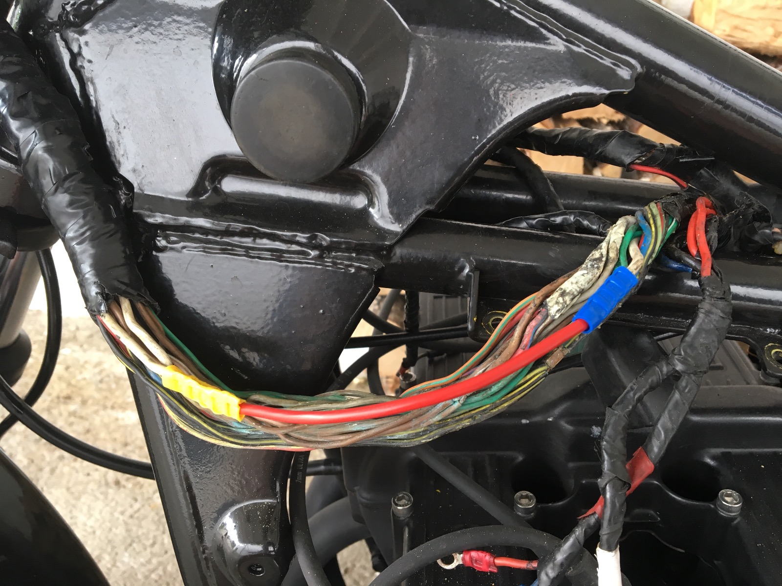

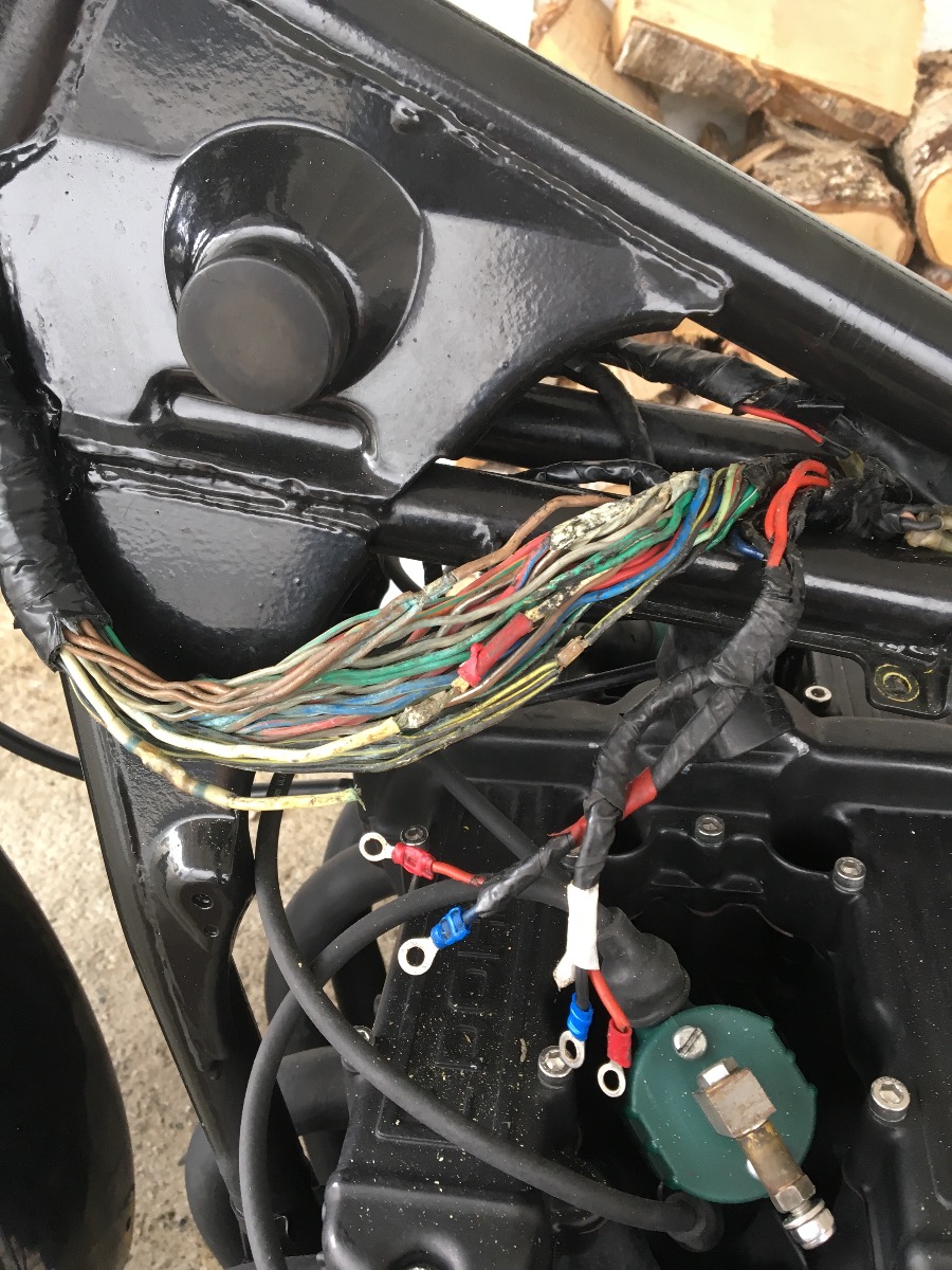

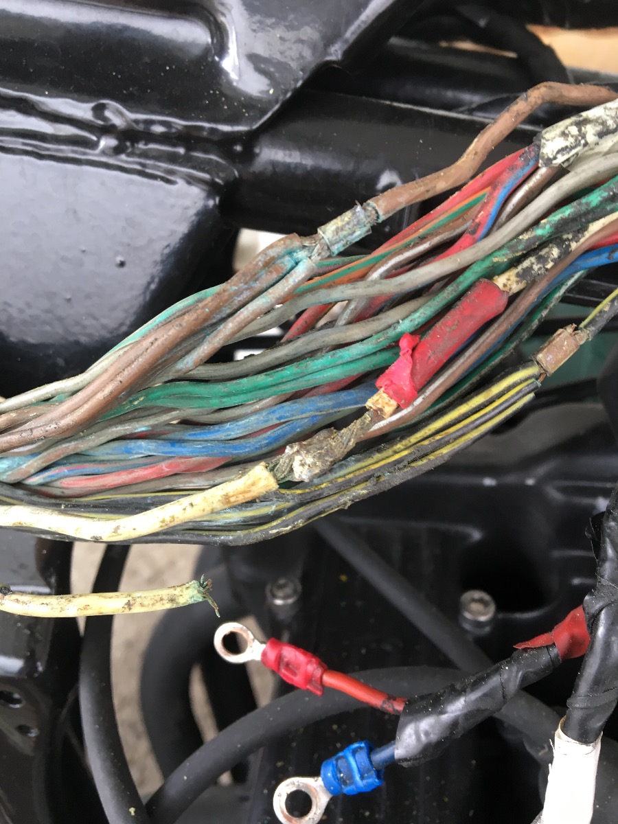

On mine kz650 sr 81, the power cable was jointed before they entered front light around wheel steering. I think the jointed orginal.
So I have had the same problem with the jointed.
Use the elimitate metod with a multimeter and see where you loose power was my procedure to find the problem.
Wiring diagram and multimeter is what you need.
