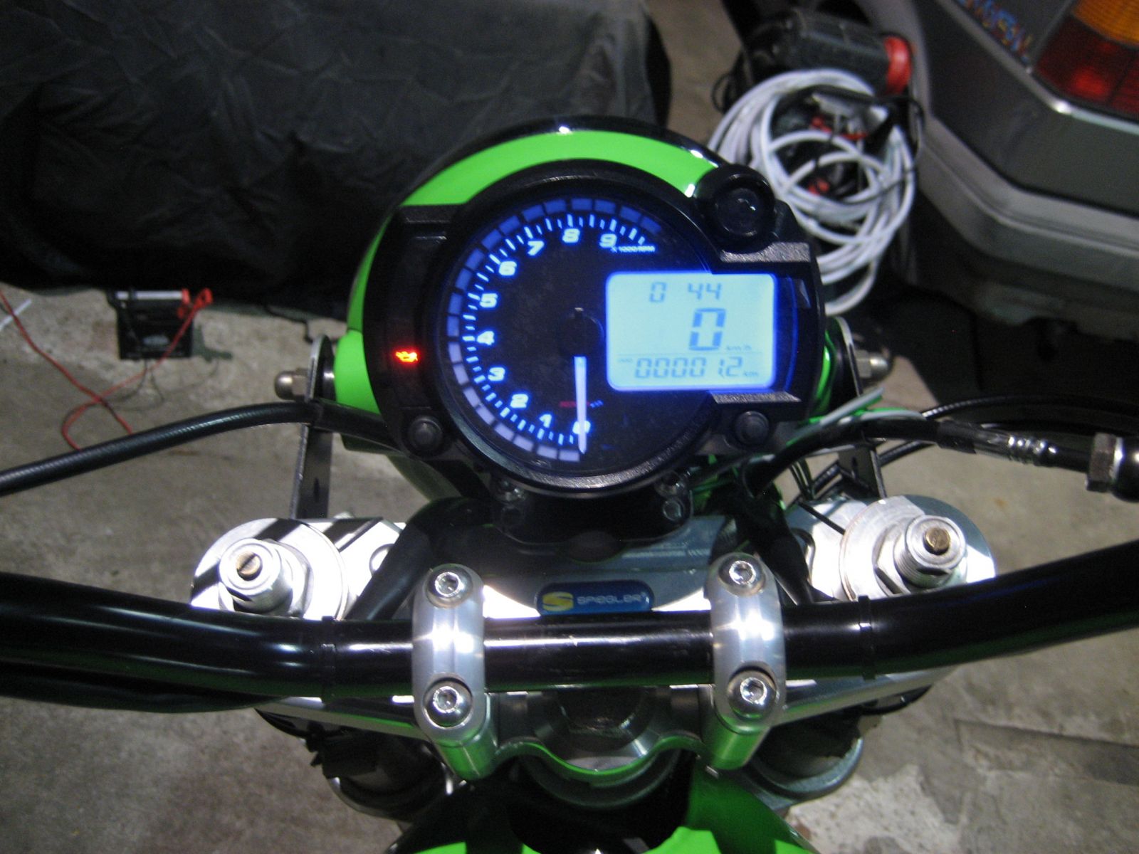

AceBandit77, have you ever thought about of a more modern gauge swap like a KOSO gauge, everything is adjutable to your bike.
KOSO has a great selection of gauges that will fit to your bike. Want to see any pics of you bike.
