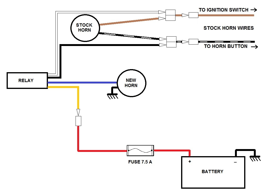

Re: Horn circuit kz1000 J3 83
14 Feb 2019 06:21
#798634
I added a second horn (LOUD) with a relay to my KZ650-C1 while keeping the original horn and the original wiring. Below is the diagram I made to document the change, it may be helpful. Ed
14 Feb 2019 06:43
#798635
650ed wrote: I added a second horn (LOUD) with a relay to my KZ650-C1 while keeping the original horn and the original wiring. Below is the diagram I made to document the change, it may be helpful. Ed
Cool so now you have a three part harmony! I'm thinking of switching to something more powerful too. My originals have 12V
and sound a bit when grounded but its not much so some more Dbs is definitely on the table...
14 Feb 2019 06:56
#798636
I have duel horns I got at HF. The relay is powered by the horn circuit and the horns get their power from the harness. Ground from the frame.
16 Feb 2019 07:04 - 16 Feb 2019 07:06
#798767
YUP. The relay takes the power directly from the battery for the horns. Not bad for less than $10.
