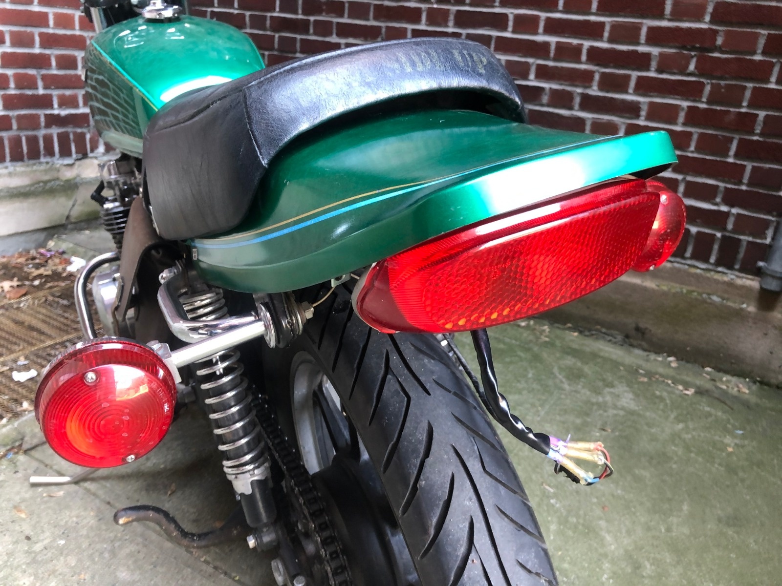

I just took a 2001 ZX6E tail light and mounted it upside down as a tail light on my bike. I want the rear to look proportional.
As you can see, Ive kept the original signal stems.
Are shorter stems sold so the signal lights would be closer to the body?

25 Jan 2019 10:25bluej58 wrote: Just cut those down
Didnt know you could do that!!!!

Z1Enterprises.com has stubby aftermarket.
Z1Enterprises >> K&S Turn Signal Stem - 35mm - Kawasaki

How do you take a headlight and mount it as a tail light?

He probably meant to type tail light. because it doesn't look like a headlight.

25 Jan 2019 11:11 - 25 Jan 2019 11:14martin_csr wrote: Z1Enterprises.com has stubby aftermarket.
Thanks. I havent taken a look yet but how do I run the wires within the stubby? Doesnt look like wires come with it. Im guessing Id have to use the old wires.

It's been a real long time since I've done a 650 but it wasn't that difficult, there is some grinding to make stem fit in the hole and a groove for the screw if I remember correctly.
The ones Martin found would be much easier if they fit the 650

25 Jan 2019 11:43 - 25 Jan 2019 11:49bluej58 wrote: It's been a real long time since I've done a 650 but it wasn't that difficult, there is some grinding to make stem fit in the hole and a groove for the screw if I remember correctly.
yeah, I was about to say they wont fit. The triangular shaped part doesnt fit in the mounting hole on the bike. I might just cut the original stems down a bit, or leave it alone. I dont want to start cutting up this bike.

The 650 looks different than Z1/KZ900/1000. At the mount. Plus they are spline cut at the blinker.
Most wires connectors slip through with the male connector
Buy another 650 set from ebay and just do it! Sure they are cheap enough.
Cut em up!!! Beat em up!!
Yes shorten them! I have to hack everything up for my 1 off build !
