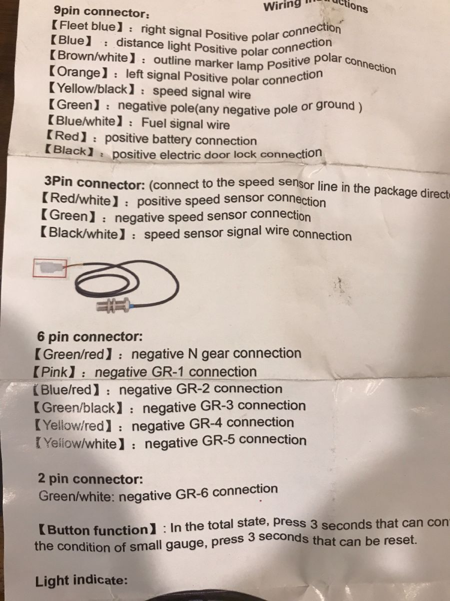

Y’all have been so helpful this past year. Omw y’all are awesome. I bought an aftermarket speedometer tachometer. It has its wiring labeled but I’m not positive how the original connectors connect to it. I could probably take way to long to figure it out but y’all seem to know what y’all are doing. So here’s the photo
Also not sure what GR-1 means.
Thanks!
Thanks!

The only information I have in it to this link. The photos I took in the last post is the supposed wiring diagram. I’m cust curious to know which wire goes where.

What crap translation/instructions, is that all you got
It looks like the gauge has a lcd display that tells you what gear the bike is in, so i imagine the 6 and 2 pin plugs are the gear position inputs.
So what ever wire gets a negative signal the corresponding gear is supposed to be displayed .
As our bikes only have a wire for neutral its the only one you can hook up.
Cant help with the door lock? but all the others look straight forward
good luck
good luck

The biggest problem is how to calbrate the Speedo without any speed sensor setup instructions/ Input push bottons.
You have to Input the wheel size/scope, number of speed sensor magnets/impulses per wheel turn to get correct speed values!!!
Buy cheap buy twice.

Since they're all negative connections, the GR stuff probably means ground. guessing. I would search youtube to see if there's a video of how to wire that one. I did a quick search & found some how-tos for some different cheap chinese meters.
Edit: found this video. appears to be the same as yours. there are other videos for it.

What's so confusing? Simple.
Connect the door lock wire to the door lock. Every bike tach connects to the doors.
