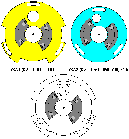

If you are trying to mount a timing plate designed for a Kz1000 motor onto a Kz650, it won't fit without major modification. (cutting, grinding, drilling). In that case, you have to be careful around the timing window. As you can see on this overlay, the Kz1000 timing window will be very close to, if not overlapping, where you need the top mounting slot for the Kz650.
If you somehow have a timing plate that fits the Kz650 in order to control a Dyna 2000, that shouldn't be a problem.
