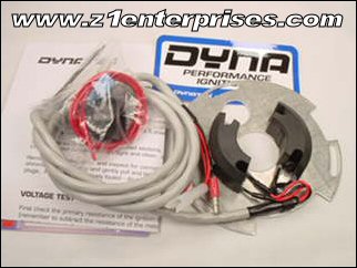

What do y'all think of the electronic ignition setups? Worth the money? Can it be installed by someone with average mechanical skills?

30 Sep 2018 19:19

SWest . . . did you also install Dyna coils? It has been recommended to me to do that . . . I have what look like brand new Emgos on the bike now . . .

I used the stock type coils until I got the Dyna 3 ohm coils. As long as they're 3 ohm or higher it will work fine. Adding the dyna coils added to the power draw. Not confident in Emgo anything.
