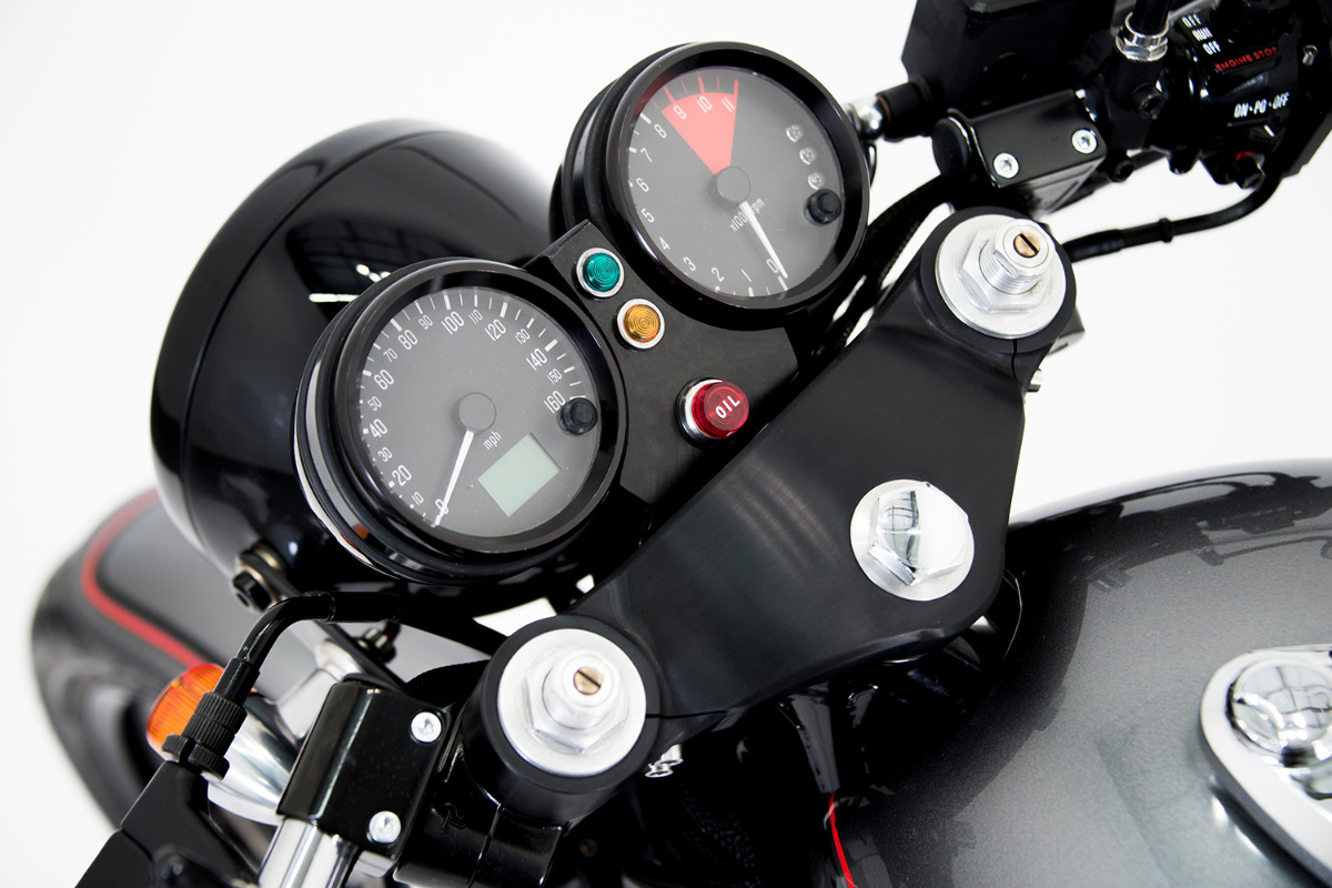

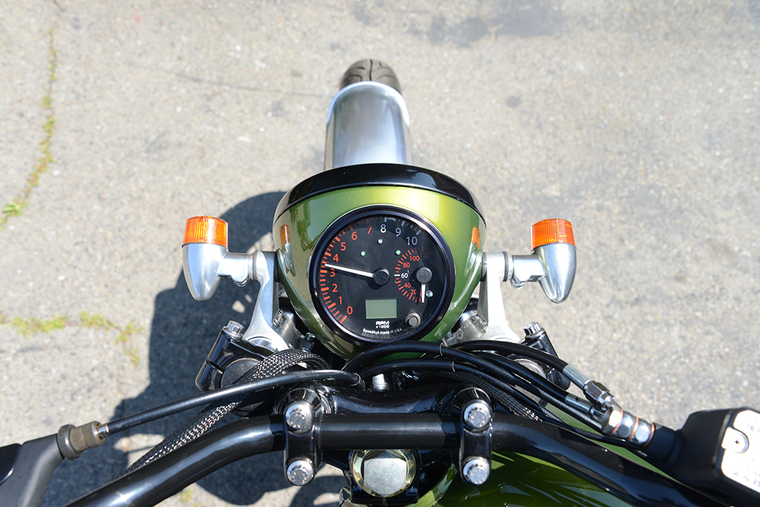

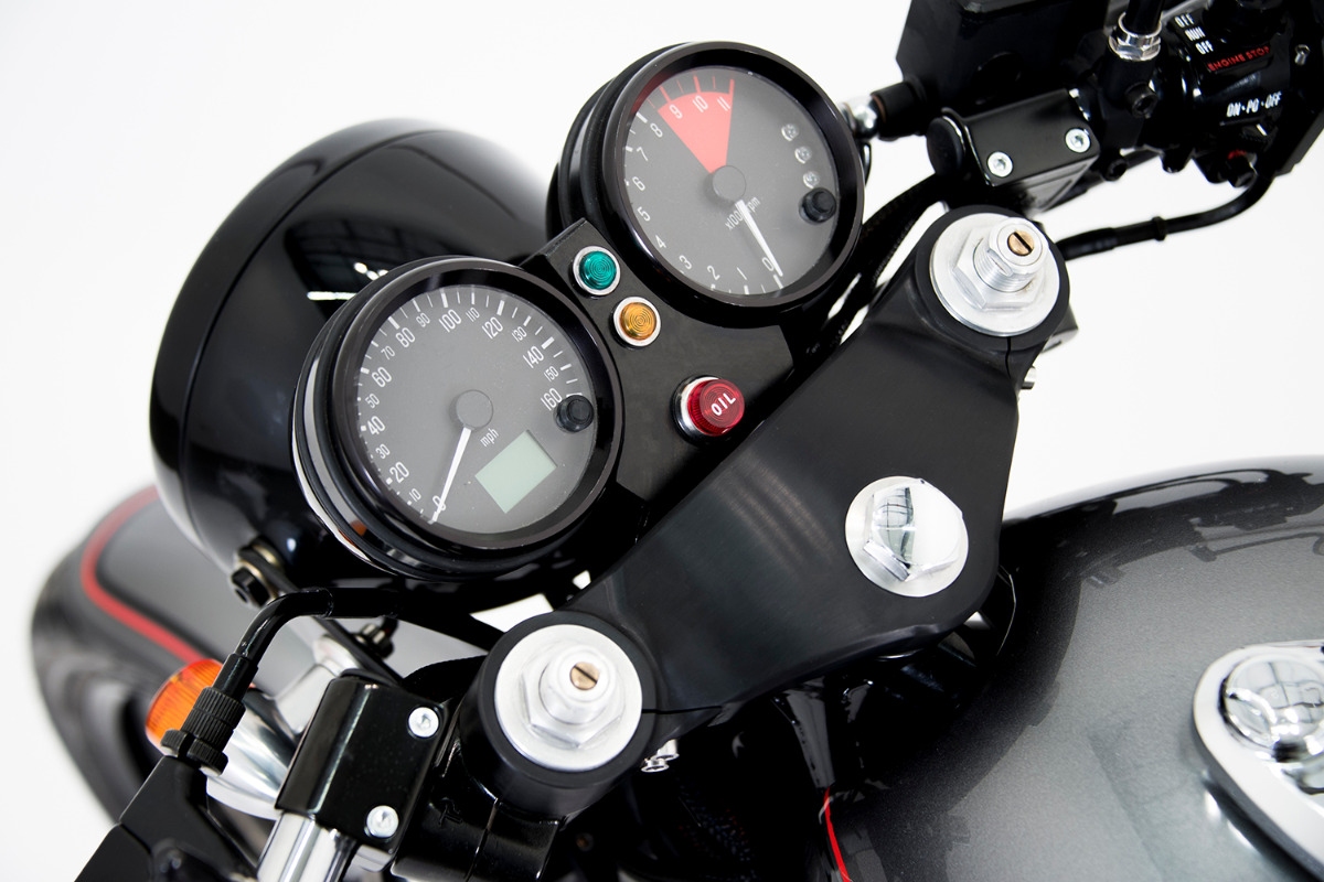

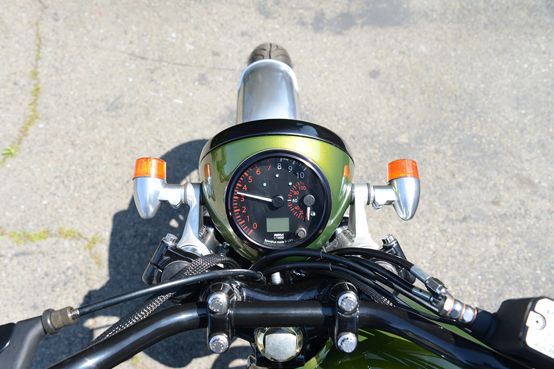

I'M using speedhut gauges on both my bikes. They seem pretty good so far. but I had issues with the tach and the the Dyna s ignition on my kz1000, i had to reroute the wires away from my coils and get a noise reducer for the tach. My kz750 is using a C5 ignition and i had no trouble there. The GPS is pretty cool but its sensitive to loosing signal, if i drive under an overpass the needle will drop.
Speed hut gauges are not made for motorcycles. They are not water proof, but resistant. However they also have a lifetime warranty. They can put a bead of silicon around the glass but you will need to make some type of cover for the back to protect the gauge.
The gauges are also very customizable. I designed custom faces and had them make them for me.
