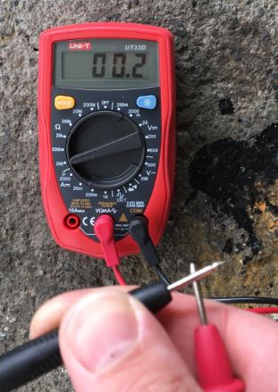

Today have I done some test of the stator.
Look like my multi meter has a 0.2 ohm offset (attached photo).
1. I checked all three cables coming from the stator against the negative pol on the battery, and all indicated open loop.
2. Measured ohm between the three cables:
A: 0,08 - 0,02 = 0,06ohm
B: 0,08 - 0,02 = 0,06ohm
C: 0,09 - 0,02 = 0,76ohm
3. I started up the engine, and when it was on idle around 1k I measured the voltage from each cable from stator towards negative pol on the battery:
A: 3 - 3.5v
B: 3.7 - 4v
C: 3 - 3.5v
Before I started up the engine the battery had 12.97v on idle 13.15 took the engine up to 5k for some second and the voltage was 13.25,
when I come down to idle it was 13.25v.
What do you say ? Must I replace the stator is the stator the issue ?

.2 ohm offset on the meter is normal.
