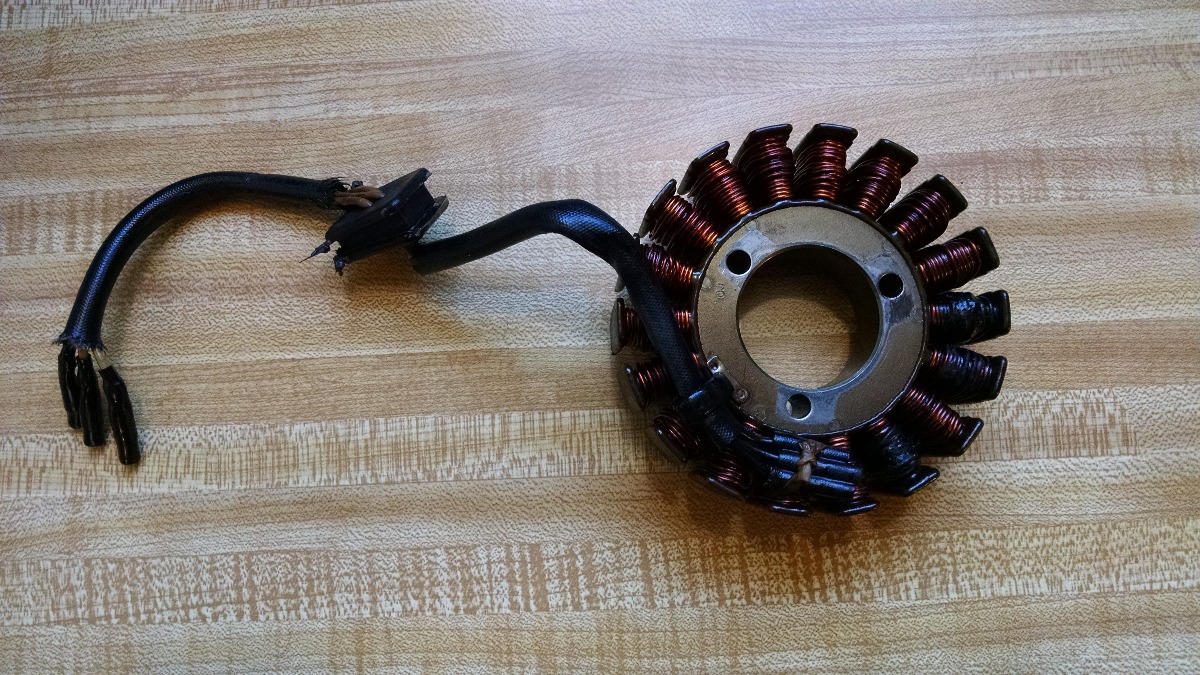

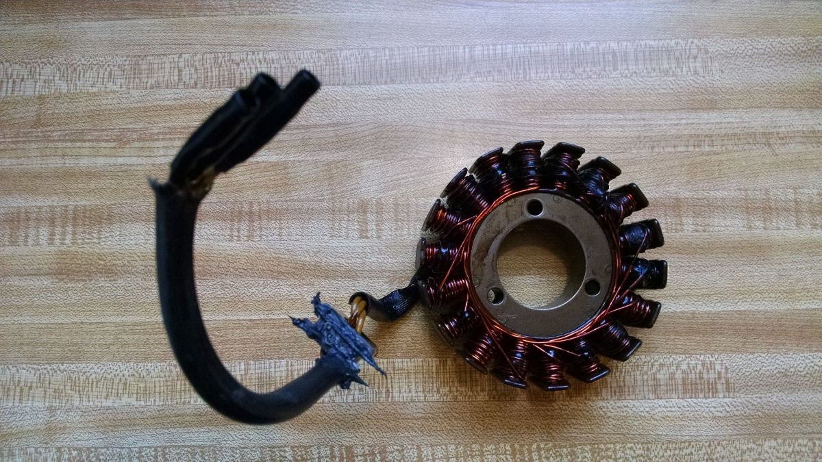

No eBay APP ID and/or Cert ID defined in Kunena configurationI had been having issues with a low battery since last fall and I kept thinking it was my fleabay gel cell battery failed after only ~ 1 year. Out of curiosity a few days ago, I started checking voltages and resistances in the charging system, and found the ignition voltage to the regulator (brown wire) was ~1 volt down from the actual battery voltage. It seemed to be low coming from the ignition switch brown in the headlight, so I disassembled the switch and cleaned it all up nice and shiny. (I had put a dab of grease on the contacts when I first rescued this bike in 2013 that tuened to nasty gunk). At any rate, I still have low votage to the votage regulator, and it seems also low votage to the ignition circuit. (what really concerns me). I also found the stator to be shorted to chassis ground and the wired actially getting hot to the regulator and I could smell letting the smoke out of my wiring harness (it is still not totally fried, YET) ., and it was still charging >13 vdc above 2K rpm.. strange behavior with a shorted stator IMHO..
ANYHOW.. back to my original question,..
I assume with 100% buyer satisfction and all 5 star reviews / 55 sold, that this Caltric Stator is working good for everyone. It was only 27 bucks with fast and free freight.. Of course, I am asking this question AFTER I already clicked "buy it now" and the order is placed. lol
