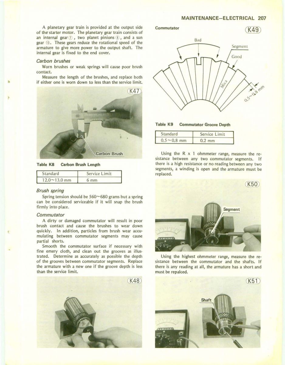

so since my starter motor had a quack still i took it apart again and realized i havent greased one of the bushings. this bushing is on the plate pictured above to the gear that goes to the planets. it was super filthy so i cleaned it up, along with the others i greased beforehand and greased them all again, cleaned the commutator very lightly with 2000 grit wet dry sand paper as i dont have emmory cloth. reassembled and i can spin it and it will spin a half turn or more freely after i let go from turning it. about to give it a shot again will see what happens! p.s. the grease im using is the grease we use on aircraft wheelbearings so id imagine itd be able to withstand a starter motor lol
