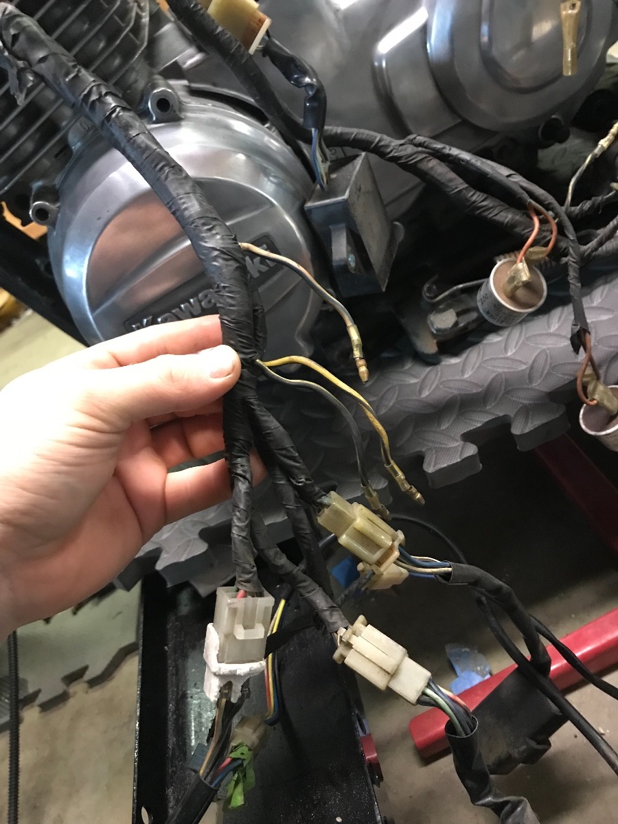

12 Feb 2018 10:24 #778609
by JohnLuke
Replied by JohnLuke on topic Help with 1982 KZ750 Spectre
Less
More
- Posts: 8068
- Thank you received: 1656
12 Feb 2018 10:44 - 12 Feb 2018 11:10 #778610
by martin_csr
Replied by martin_csr on topic Help with 1982 KZ750 Spectre
1st pic. There is a yellow-black ground wire near your thumb. What color is the other wire & the one above those two?
Yellow-black may be either for the voltage regulator or the battery neg (-) terminal. notice in the wiring diagram that it shows bullet connectors. ie, arrows pointing to double rectangles indicating that those 2 have double female bullet connectors.
Notice that the blue-white wire from the fuse box has a single female bullet connector.
1st pic. you'll need to replace that damaged connector.
2nd pic. If that connector only has 2 wires, green-white & black-yellow, then that's for the fuel level switch on the fuel tank.
