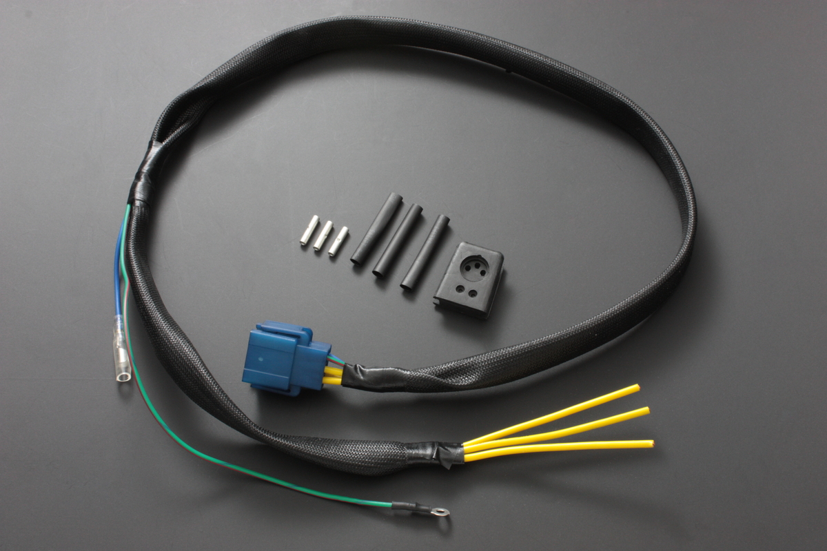

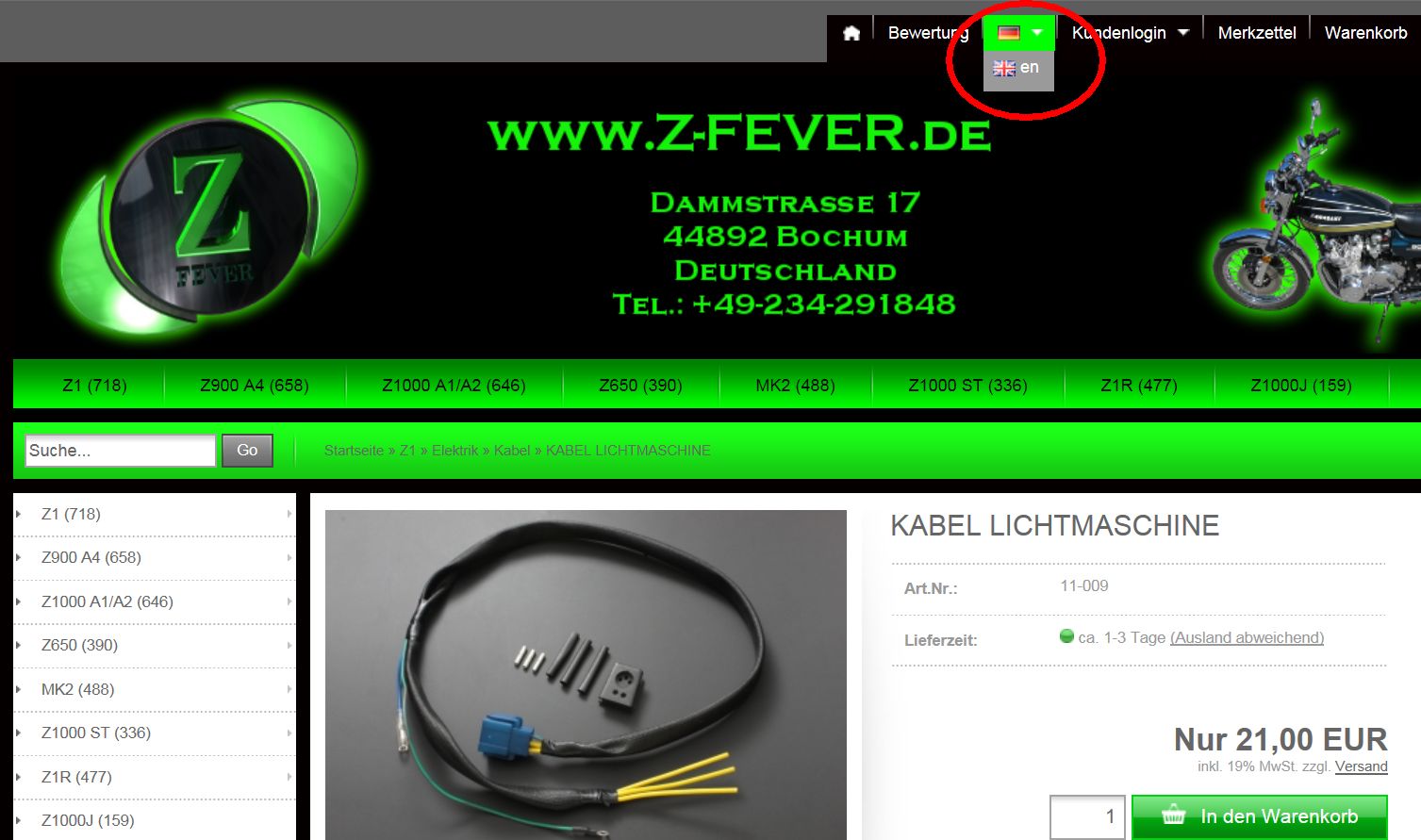

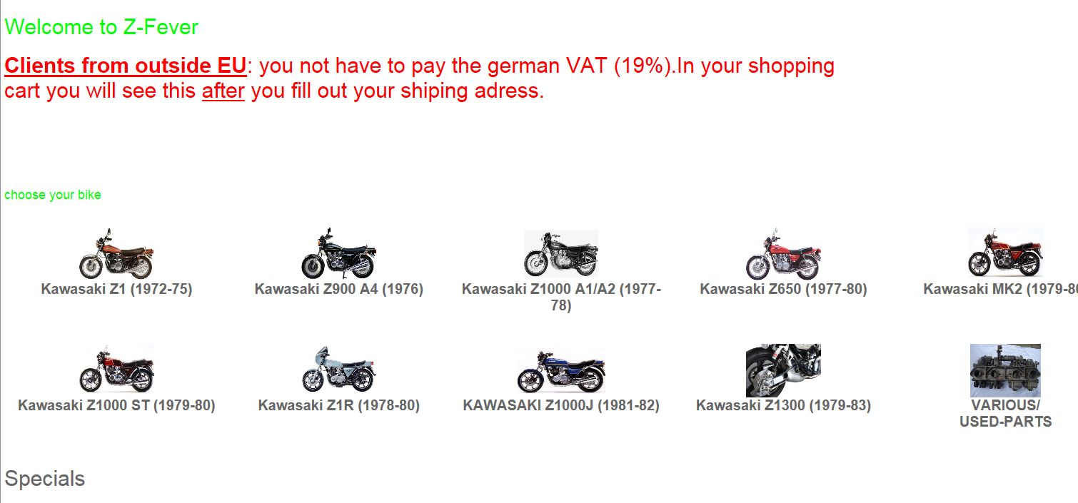

- Posts: 4420
- Thanks: 2269
Re: 78 kz 1000 plug and play
05 Feb 2018 13:57
