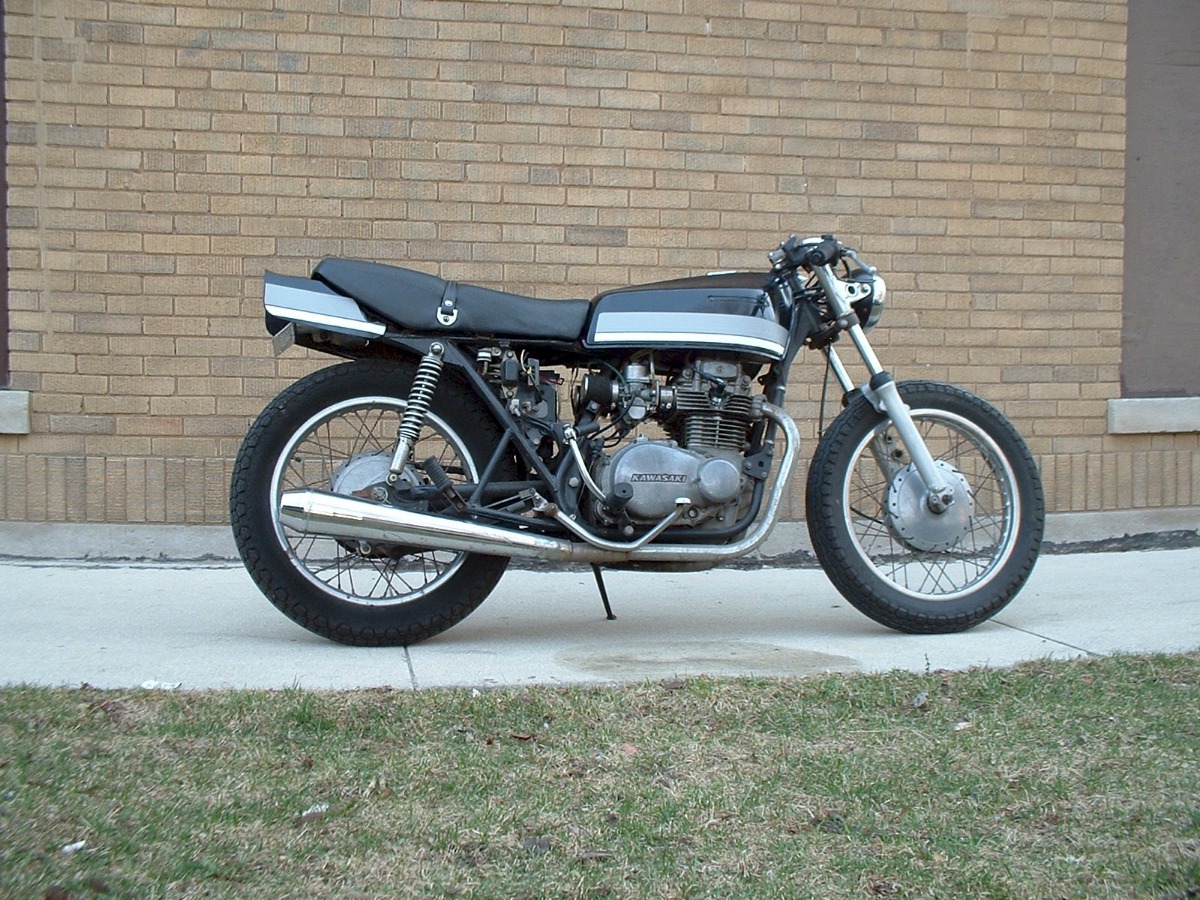

22 Sep 2017 08:27 - 22 Sep 2017 08:41Nerdy wrote: Tuning the stock carbs with pods is essentially impossible. Do not attempt. People have been trying to do this for YEARS and it seems no one has ever succeeded. CV carbs simply do not like pods and no amount of effort will make them behave as well as stock. Seriously. Don't go down that path.
The bike (1976 Kz400S2) in this photo is running pods. It took us about a half dozen or so combinations to jet it.
Yes, it was not as easy as mechanical slide carbs, but certainly not as impossible as you make it sound.
The bike ran great in hot weather and cold for many years. And yes we added a front fender later. The photo was from one of the first days we were modifying the bike.
City driving, as opposed to highway, is more taxing on a bike with running issues. He was a new rider back then, so it's not like he had experience driving troublesome bikes either. As you can see he rides it with no problems. It was his only vehicle for several years, including winters.
