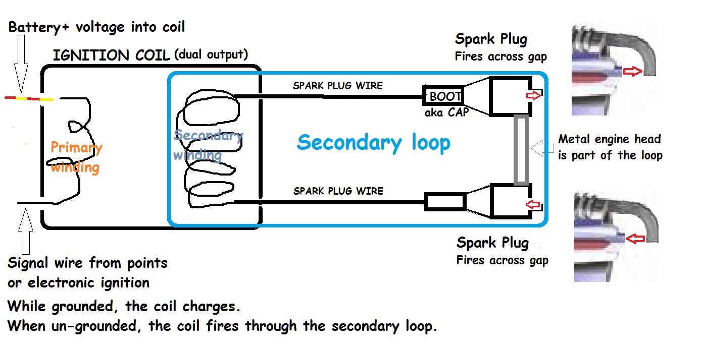

15 Jan 2017 10:28 - 15 Jan 2017 10:33Patton wrote: . . .
One and only one resistance component may be used in the secondary loop (i.e., cap OR wire OR plug).
More than one resistor component is too much resistance, which weakens spark.
Actually don't need any resistance component in the secondary loop, which many owners achieve by fitting non-resistor caps to the stock wires and keeping the same stock non-R plugs.
Running without a resistance component in the secondary loop is expected to cause radio interference (if that matters). . . .
When checking plug spark, will have to look really fast to see which way the spark is jumping between the center electrode and the ground electrode. :lol: :lol: :lol:
