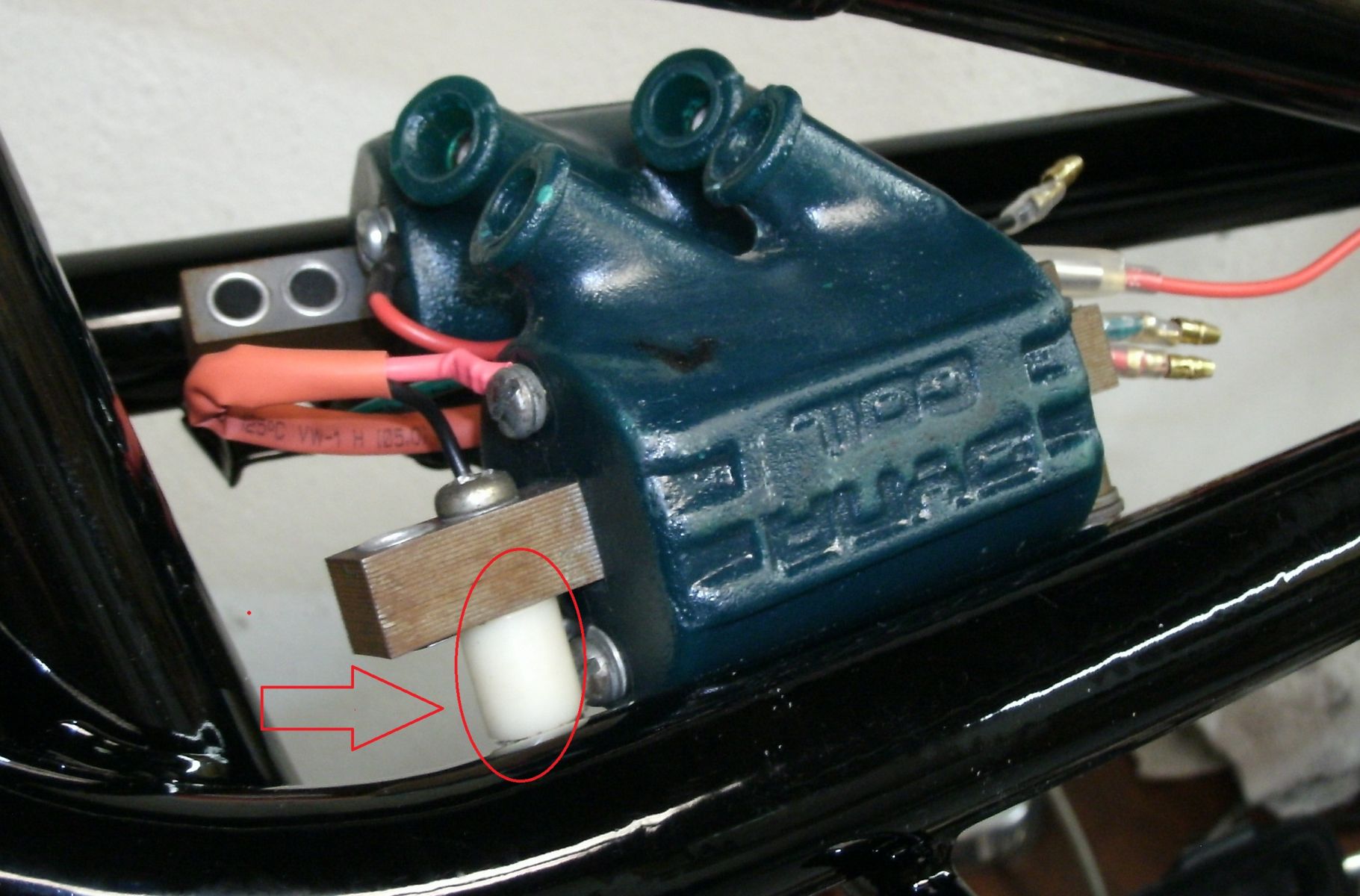

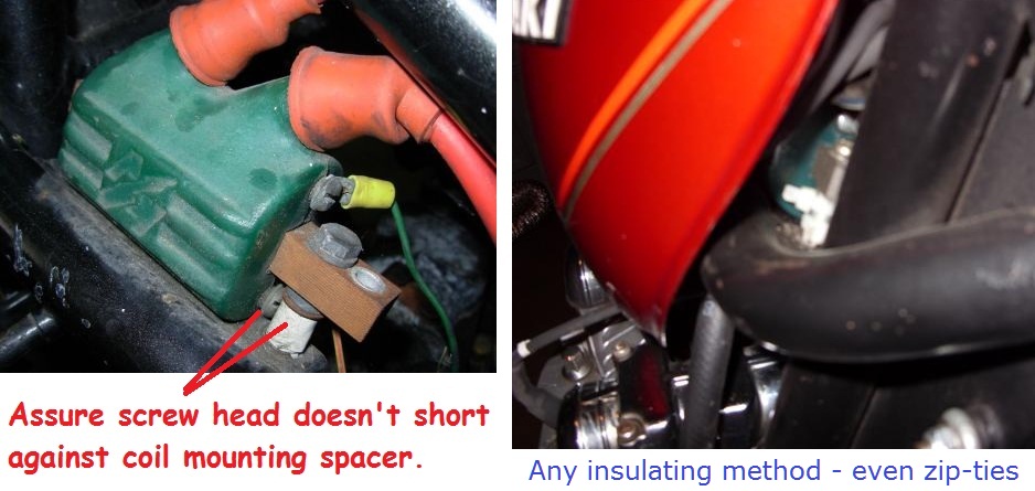

One note of caution when installing the Dyna coils.
On each coil, one of the primary terminals has a screw head that's very near to and sometimes may touch and short against the spacer that's used when mounting the coil.
Be sure there's space between the screw head and the spacer.
A non-metal (non-conductive) spacer can be substituted for the factory metal spacer.
Or insulation can be placed between the screw head and the spacer.
Many years ago, I used a zip-tie around the spacer as a temporary solution, which works well and has been there ever since.

Mine hang upside down and have a screw in connection. See the pic and there is a spacer.
