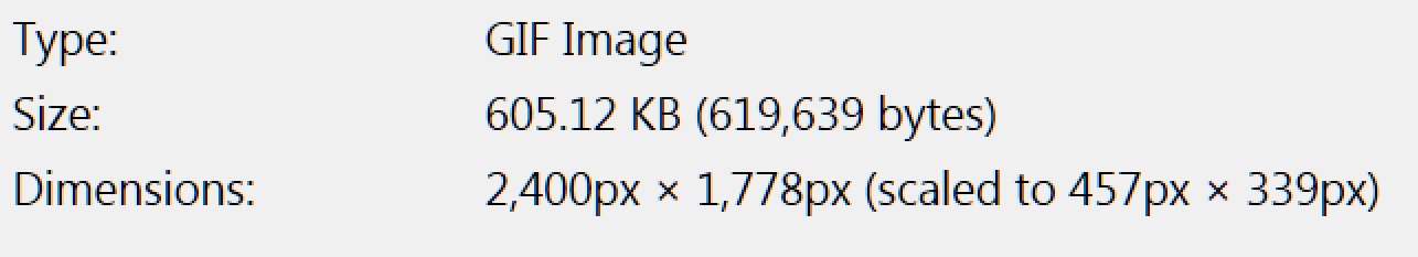

04 Sep 2016 09:16 - 04 Sep 2016 09:17My original file, which was a Gif, and successfully uploaded to KZR was 2675 x 1982. If you download the KZR hosted version, it is 2400 x 1778.davido wrote: Ill tell you now that KZr doesnt resize anything.
In order to not hijack this thread, I'm posting image related issues on this thread.
www.kzrider.com/forum/8-about-the-site/6...host-large-gif-files
In that thread you can see the results of the KZR re-sizing a gif.
