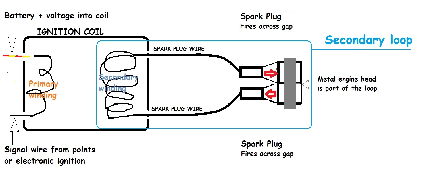

Would first assure that 12 volts is being received at the ignition coil primary terminal (perhaps via a small red or red/yellow wire).
In event 12 volts is NOT being received at the ignition coil primary terminal, will then need to determine why 12 volts is NOT being received at the ignition coil primary terminal.
