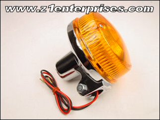

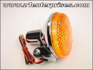

Re: Front Signal lights
04 Jun 2016 07:50
You can get these. Duel filament.
www.z1enterprises.com/product/KS25-2195
www.z1enterprises.com/product/KS25-2015
