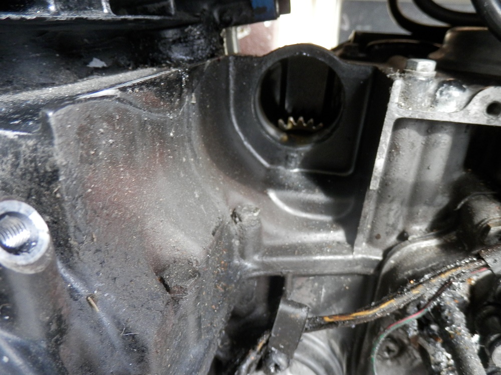

Is your starter motor on the left side of the bike ?
Like this ?
If so and if you removed the retaining bolts AND the long bolts which hold the motor together and pulled, then I could see the motor coming apart leavinghalf behind.
You could try to re insert the long bolts and then pulling.
When the startr motor is pulled out this is what you see............. assuming yours is like mine.
Is the F model a shaft
