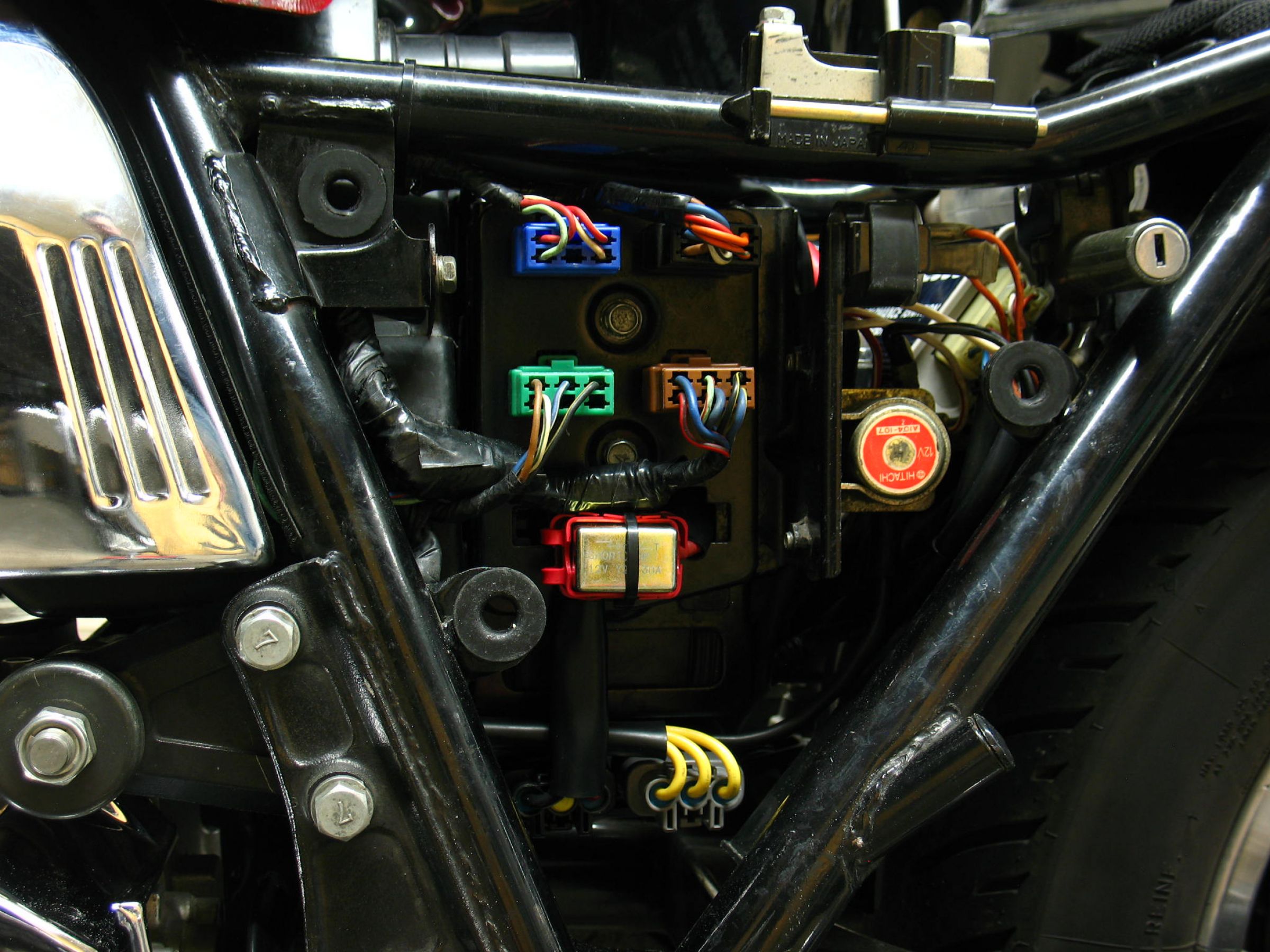

Here is how the electrical panel on my 82 1100A turned out.
If you choose to go that route and install it correctly, you won't be disappointed with the results.
In addition to the Shindengen SH775, you will need a special connector with wires n-stuff. I bought a kit from Roadster Cycle (Jack Flemmiing) which has everything needed to hook it up.
See:
www.roadstercycle.com/
