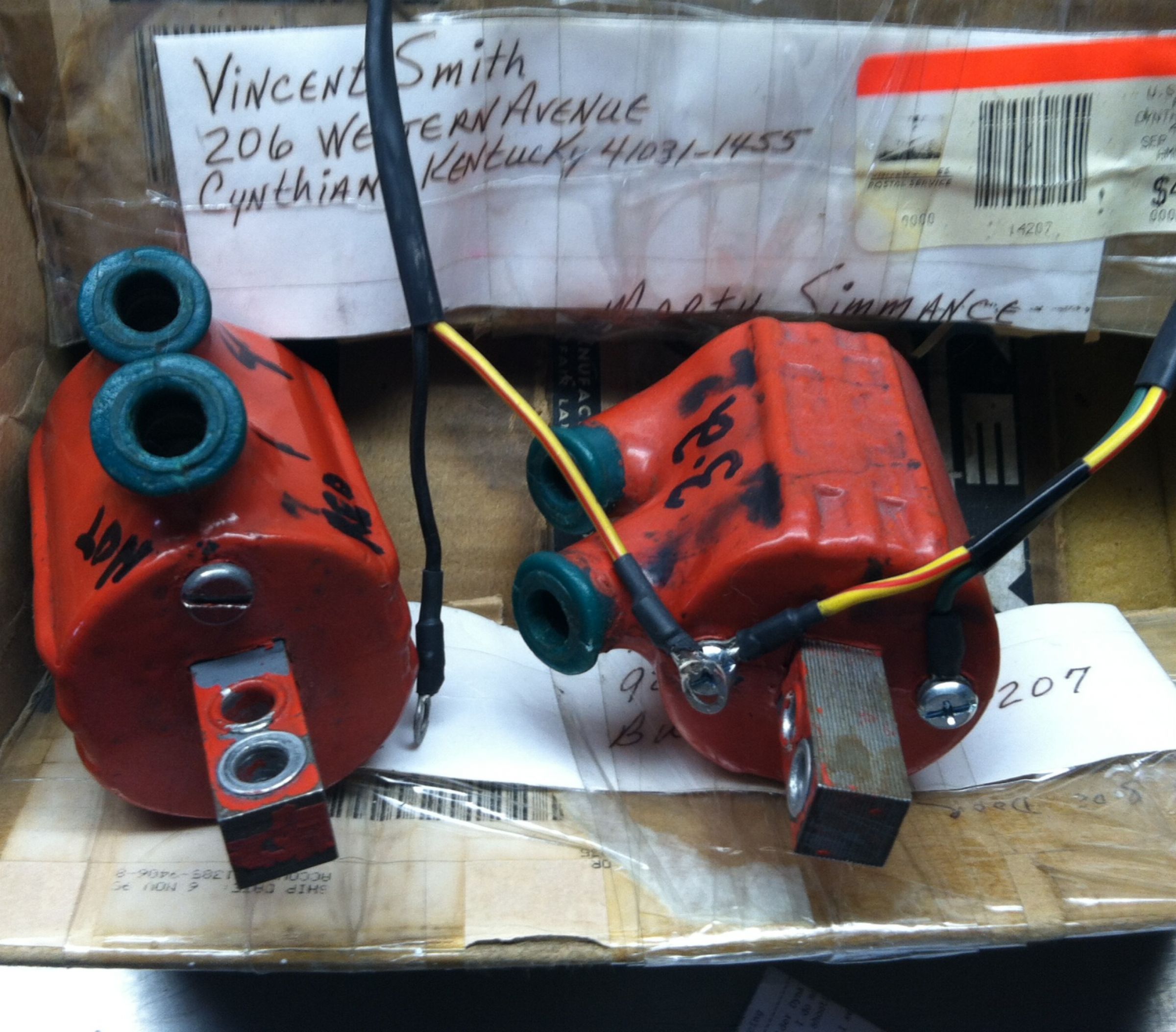

Question? The bar? stem? or whatever you call it, the mount in the center of this coil is loose.
It can be tapped back and forth a little. i moved it a 1/8" at most. I know they are epoxied around at the start of moulding it to produce.
Been sitting for 16 years. Got burned buying a bad Ignition DYNA S. One of the pickups were bad. At least I got to use the nice copper core Accel yellow wires. Glad I never sold them on ebay. I would have unknowingly sold the coils.
But they might be good? Any? Thing?

The big problem is if the core slides enough to let the mounting bolts touch the wire scews. Use a plastic sleeve around the standoff, or even a strong plastic standoff, as an insulator to prevent shorting.

The middle part is the laminated iron core of the transformer. Being a bit loose shouldn't hurt performance but as pointed out, make sure the coil terminals can't ground out.
If you want you could Superglue the core to stop it from moving.

04 Mar 2016 01:17There really is no way to properly test an old coil with an Ohm meter. It won't detect the typical "arc over" internal shorts these HV transformers develop with use. I have a really bad attitude about old coils because two in a row gave me serious grief.z1kzonly wrote: But they might be good? Any? Thing?

16 Mar 2016 13:42Any coil can be checked out of car. Install spark plugs and connect them together (threads). Momentarily connect primary coil to a battery and watch for spark.bountyhunter wrote:There really is no way to properly test an old coil with an Ohm meter. It won't detect the typical "arc over" internal shorts these HV transformers develop with use. I have a really bad attitude about old coils because two in a row gave me serious grief.z1kzonly wrote: But they might be good? Any? Thing?

You can also use some wire to connect coil mounting holes to battery.
You also check spark on bike w/o any tester,

That does nothing for testing under load.

Some coils might not even give a spark without a condenser in that simple setup. And like Steve says, it doesn't really stress the coil like the bike would. It does test some aspects, but a more throrough test is needed to safely say the coil is good (and won't get you stranded).
