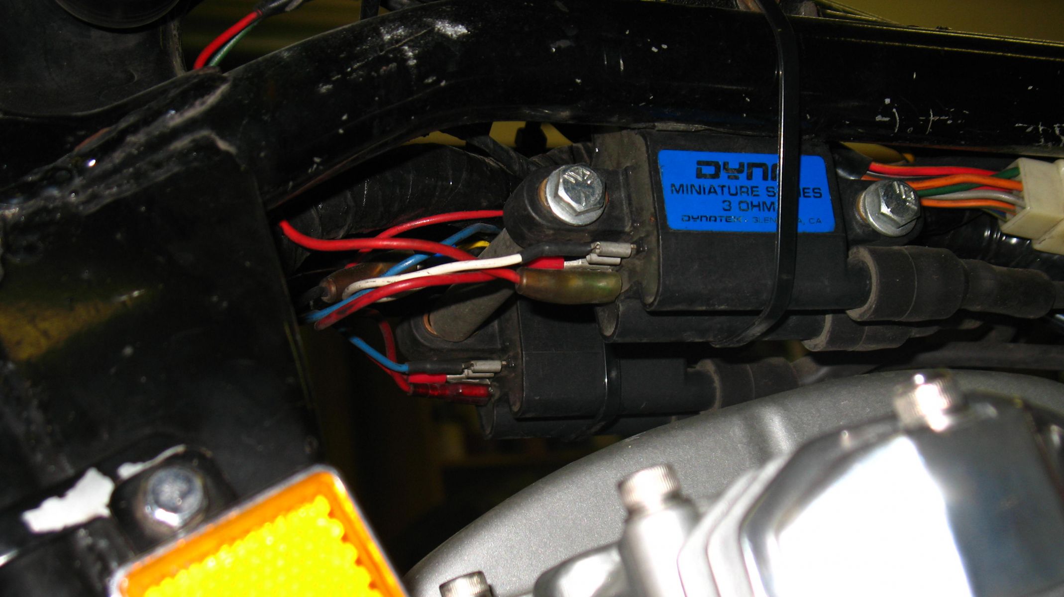

Thanks dave! I found a set of both those and the regular green 3 ohm dynateks. Your bike looks amazing, looks like you had to macgyver those into pace a bit though. They didnt fit the original brackets?

Yep, had to improvise mounting these. Two end-tapped lengths of 1/2" aluminum rod, made a dual-coil assembly to wedge snug up-between the frame members...held firmly in-place now with a long nylon/velcro strap wrapped around the frame, eliminating the need for the zip-ties

Hmmm i just order a pair off ebay, i guess ill have to mount my uniquely too. Can i reuse my stock wires and just replace the connections on both ends with the connectors the kit comes with? And do i really need a crimp like the website says? Theres got to be a way to crimp with just pliers or something

25 Jan 2016 20:12cafebrat wrote: Hmmm i just order a pair off ebay, i guess ill have to mount my uniquely too. Can i reuse my stock wires and just replace the connections on both ends with the connectors the kit comes with? And do i really need a crimp like the website says? Theres got to be a way to crimp with just pliers or something
I used factory pre-crimped ends that came on the Dyna DW-200 7mm solid-core plug wires for attachment to the coils. The other end has NGK spark plug caps, simply threaded onto the cut wire...no crimping required at all.
