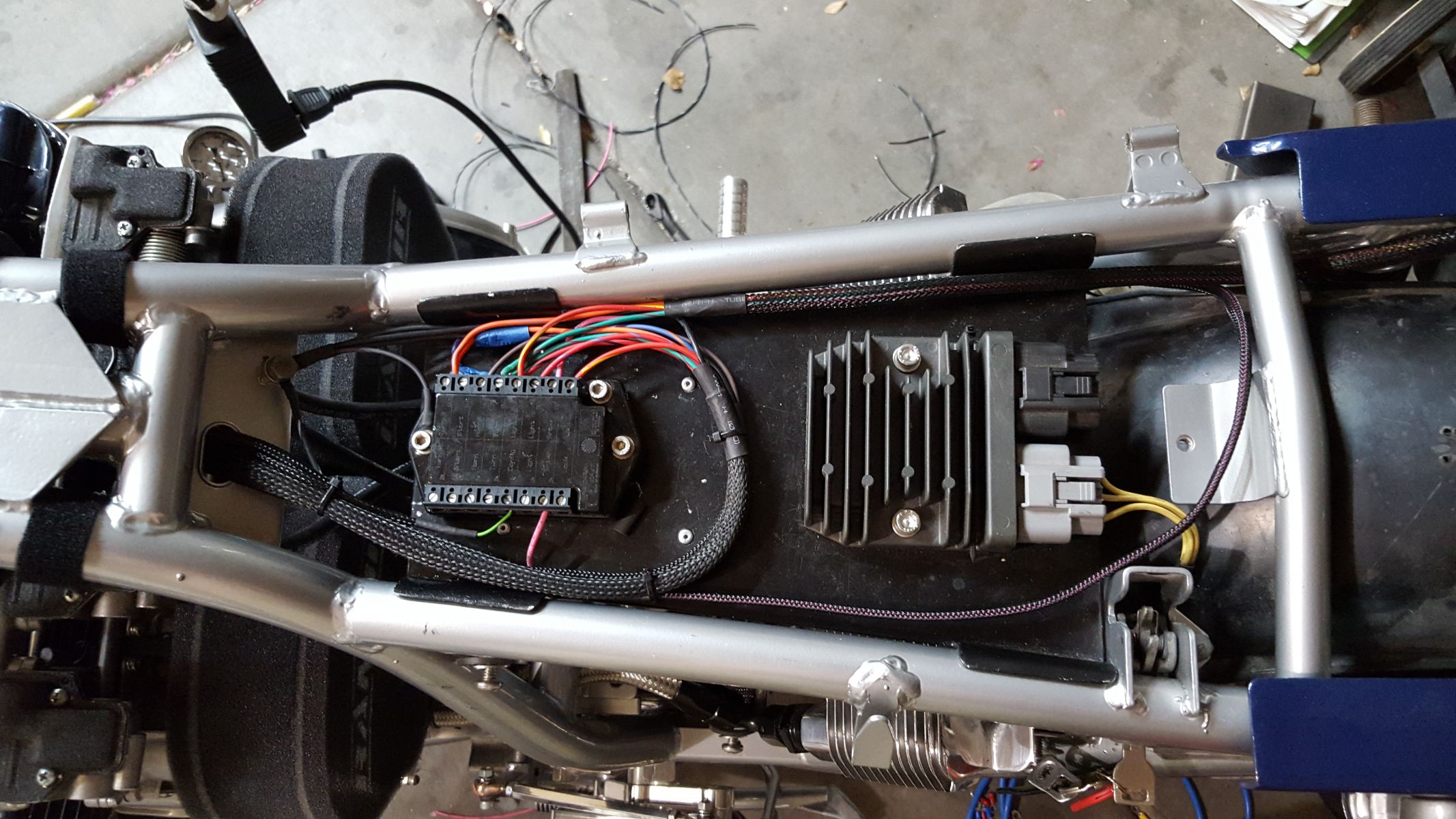

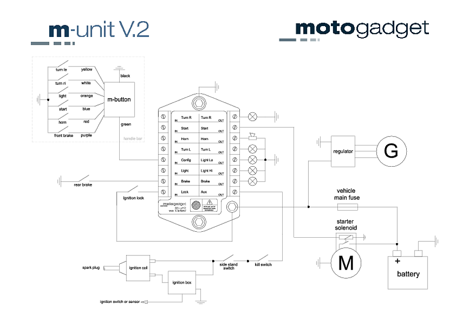

Yep not running yet though. I used the M-button for the handle bars, so there is only one wire from bars to M-unit. I also splurged on the M-switch so no more ignition key.

Looks good. Did it reduce the amount of wires significantly?

Yes i would say so. Not the M-unit itself but the M-button, because you only have the one wire coming from the hand controls. I am not an electrical guy by any means so it helped to simplify things.

The hardest part for me was figuing out my starter relay because it was for a different bike. I re-wired everything. I am not a wiring guru and this was very straight forward. I love the m-Unit.
