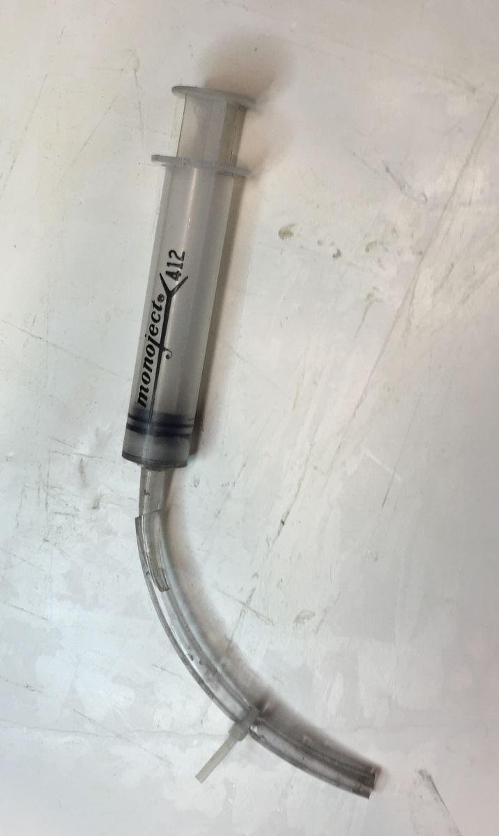

Here is what I use:
The wire wrap at the end stops the tube about 3/8" over the top of the plates so that as I suck electrolyte back out, it sets the water level about dead center of the fill lines on the battery.
