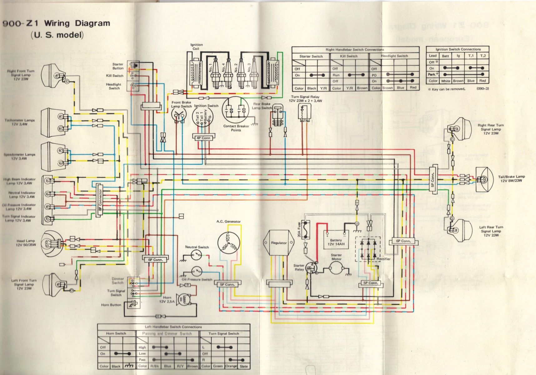

Your main 'big' fuse powers the head, tail, ignition fuses, fed through the ignition switch.
The fact that your main fuse is blowing instantly makes me think the problem will most likely be between the fusebox , to ignition switch, and back to the other fuses. Usually white/red
from battery + to main fuse, and white to ignition switch.
If your other 10 amp fuses were blowing but the 20 amp main fuse was intact I'd think otherwise. Try lifting the tail and headlight fuse out and see if the problem remains.

The Z1's only had one fuse.
