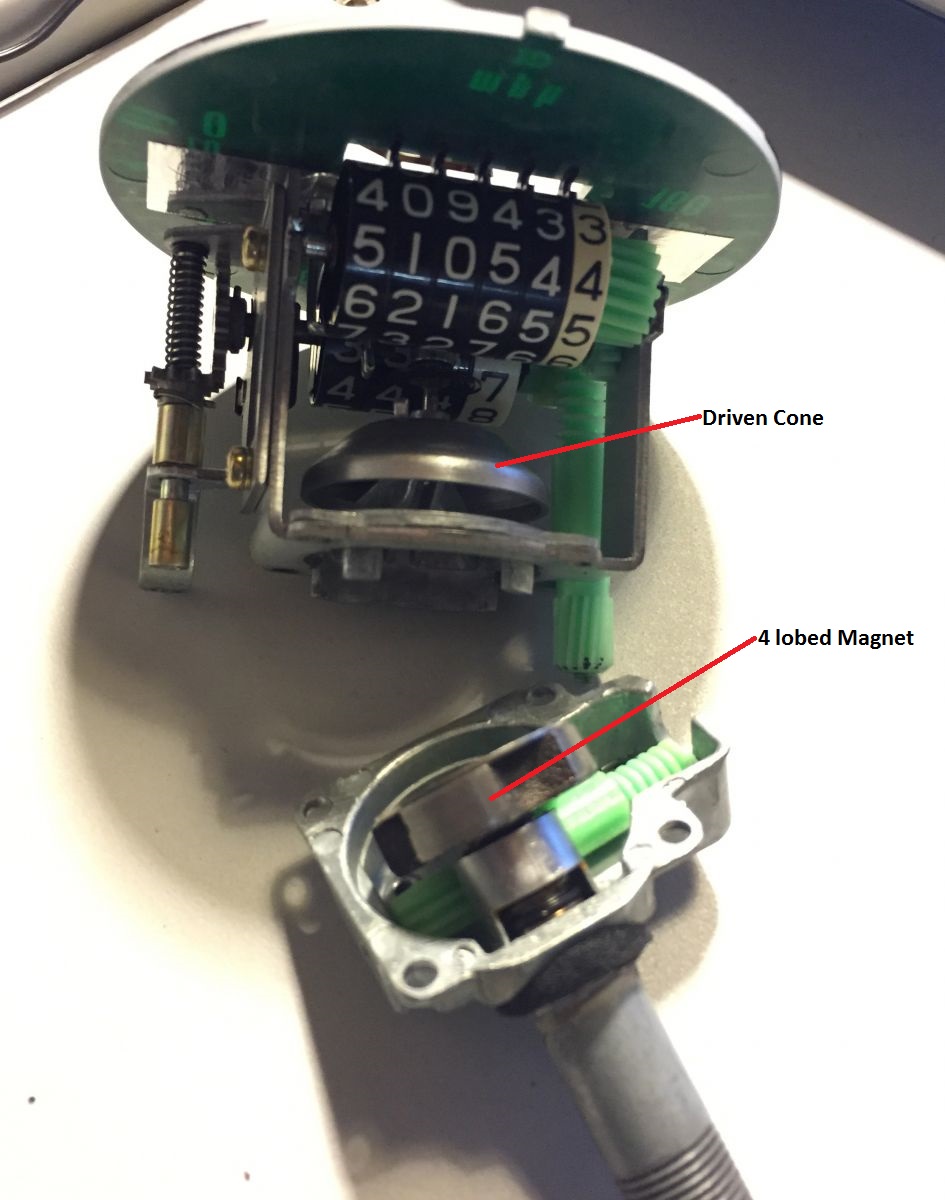

Even if it is just for those among us fearless to gut and or take an ND speedo or tach apart.... when someone actually figures out how to calibrate one of these instruments, write it up and post it ASAP!!! LOL!!
I think it does have something to do with how deep the four pole magnet is inserted into the conical cone, driving the needle shaft. But I have been proven wrong on this site a few times too!

I can't say with certainty, but I am quite skeptical there is a way to change the magnetism in any meaningful and or calibrated way.
I'm still thinking the four lobe's proximity to the drive cone is the way to "calibrate".
Now, doing that could still fall into that statement "... It is done by changing magnet strength in the gauge drive", as moving it closer or further from the cone would change the effect of the magnets, or strength relative to the cone.
Also, that clock spring in there, wound around the driven shaft, can't be just to return the needle to zero. I suspect that has some dampening effect too.

He also said something about a oil filled drum. There isn't one on these. I suspect the shaft is just sloppy and there is no way to fix that.
- missionkz
- Posts: 1612
- Thanks: 182
Re: 1992 KZ1000P Speedometer is off
08 May 2015 15:43
Yeah... I think we both might be fighting a worn shaft bushing and or bearing, causing the cone to wobbly a little.....
