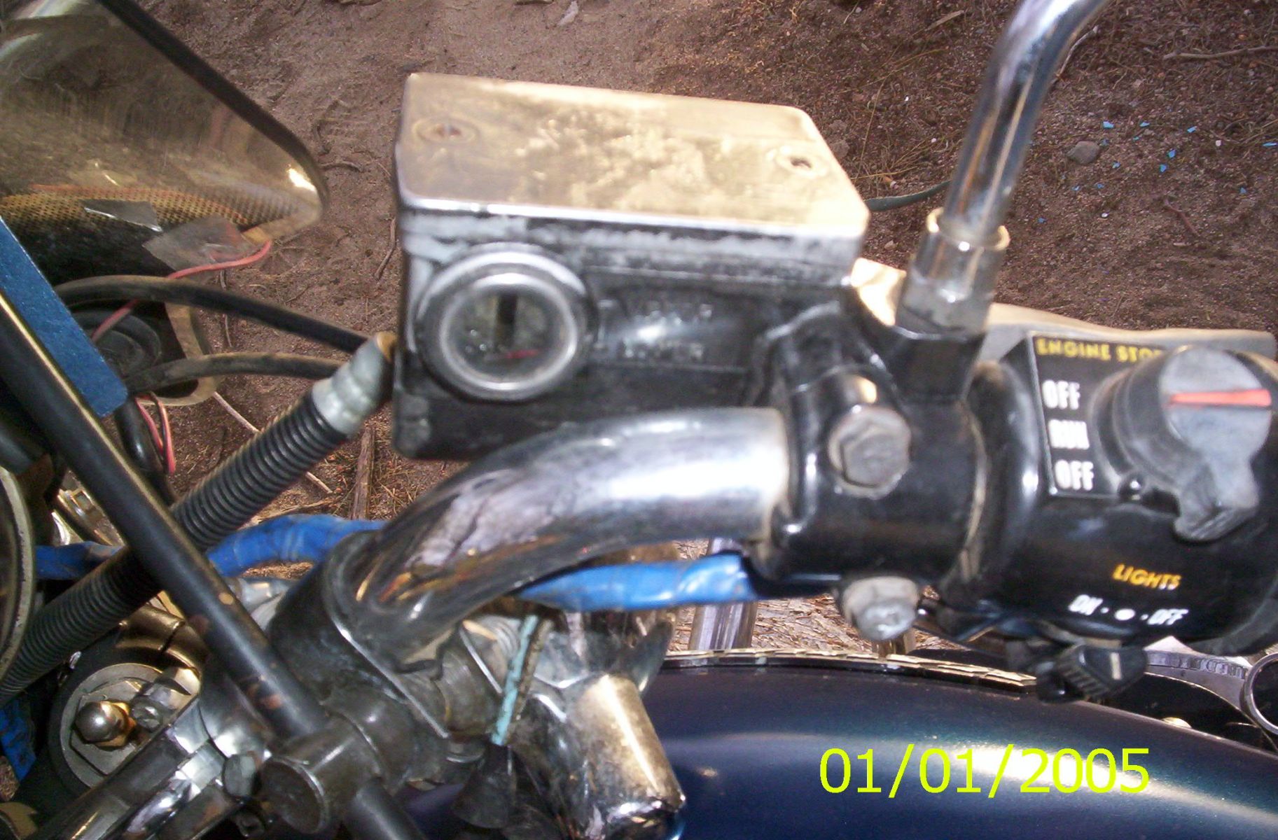

I went through both of my controls when I didn't have the money for the engine. Dirty, dry and corroded. I cleaned them up and they work fine. The high beam switch broke so I bought a new aftermarket one from Z1 parts inc. $45
I'm keeping the stock one. It's is worth money rebuilt. A Z1 you know. It has the date code.

17 Apr 2015 17:50Yeah, my switches looked about the same. Cleaned um up with some ele contact cleaner and a small brush. So far they seem to be working fine.swest wrote: I went through both of my controls when I didn't have the money for the engine. Dirty, dry and corroded. I cleaned them up and they work fine. The high beam switch broke so I bought a new aftermarket one from Z1 parts inc. $45

Clear tube test on the carbs.
A little trick. When painting the switch blocks, paint the black first, then use oil paint for the letters and such. Use a Q tip then wipe off the excess. That's how they've done it for ever.

Got ya. I'll try some clear tube. Thumbs up on your controls. Has a clean look.
I painted inset letters/numbers like that back when I was doing stenciling in a machine shop. Everything had to have the part number on it and they wanted it to be easily seen. But all we had to do was spray um white and wipe off the over spray.
Here's another little tip ... Fingernail polish works too. Its also impervious to gas and oil. Have to use acetone/nail polish remover to clean/remove it. Plus they have every color you could possibly want, Also works good to seal those small plugs you often find on carburetors. (look like tiny freeze plugs) Pop it in and paint a little nail polish around the edges.
