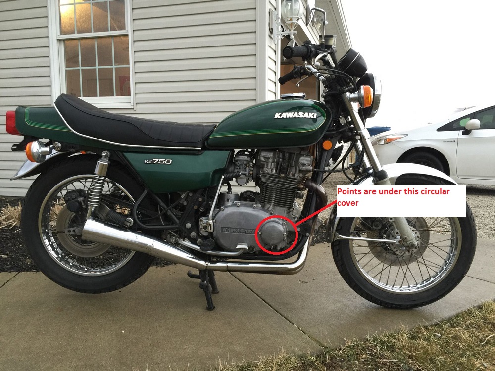

Washed my KZ. Now won't start??

05 Apr 2015 20:16Here's what I know: if it's the original coil, it needs to be replaced. The coil bodies crack over time and moisture can get in. Even if it runs sometimes, if it is cutting out the coil is likely bad.
As stated, take off the tank and verify that 12V is getting to the hot side of the coil. If so, take a plug out and press against the head and crank over and check for spark.

Check the fuses. They pop sometimes after pressure washing

Just got home and getting ready to pull the cover off the points. I had to just try to start it again and BOOM! It started right up! Lol!! Crazy! I will keep investigating thow. THANK YOU ALL SOOO MUCH!
