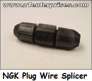

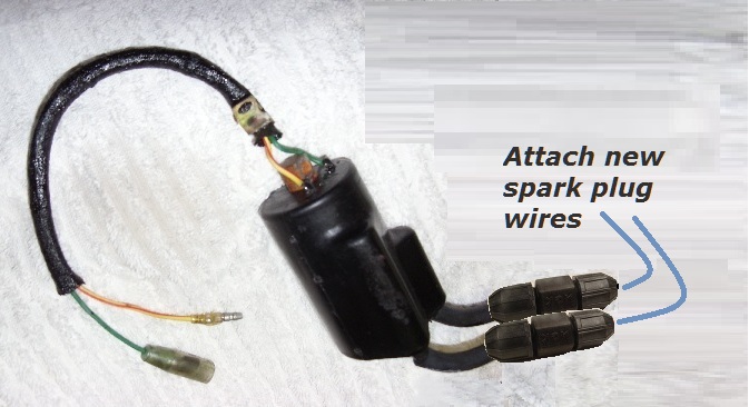

After replacing the stock points ignition on my KZ900 Ltd with a Dyna-S, I continued using the original coils with built-in plug wires. The coil primary wiring passed the ohm test and the secondary circuit also passed the ohm test (plug cap to plug cap). Eventually, the plug wires deteriorated to the extent of passing enough voltage through the engine and frame to produce an "electronic buzzing" felt through the fingers when switching the petcock onto reserve while riding. That's when I decided the old hard cracked plug wires definitely needed replacing, which of course also required replacing the stock coils.
In a situation where the stock coils are still functional, but the integrated plug wires are deteriorated, there's a plug wire "splicer" available.
The old plug wires could be cut off, leaving a short stub to which the splicer is attached, and new plug wire running from the splicer.
Imo, splicer money is better spent toward new coils, because the existing stock coils, even if serviceable, are likely nearing the end of their useful lives.
Would correct the ignition system before fooling with the choke pads.
