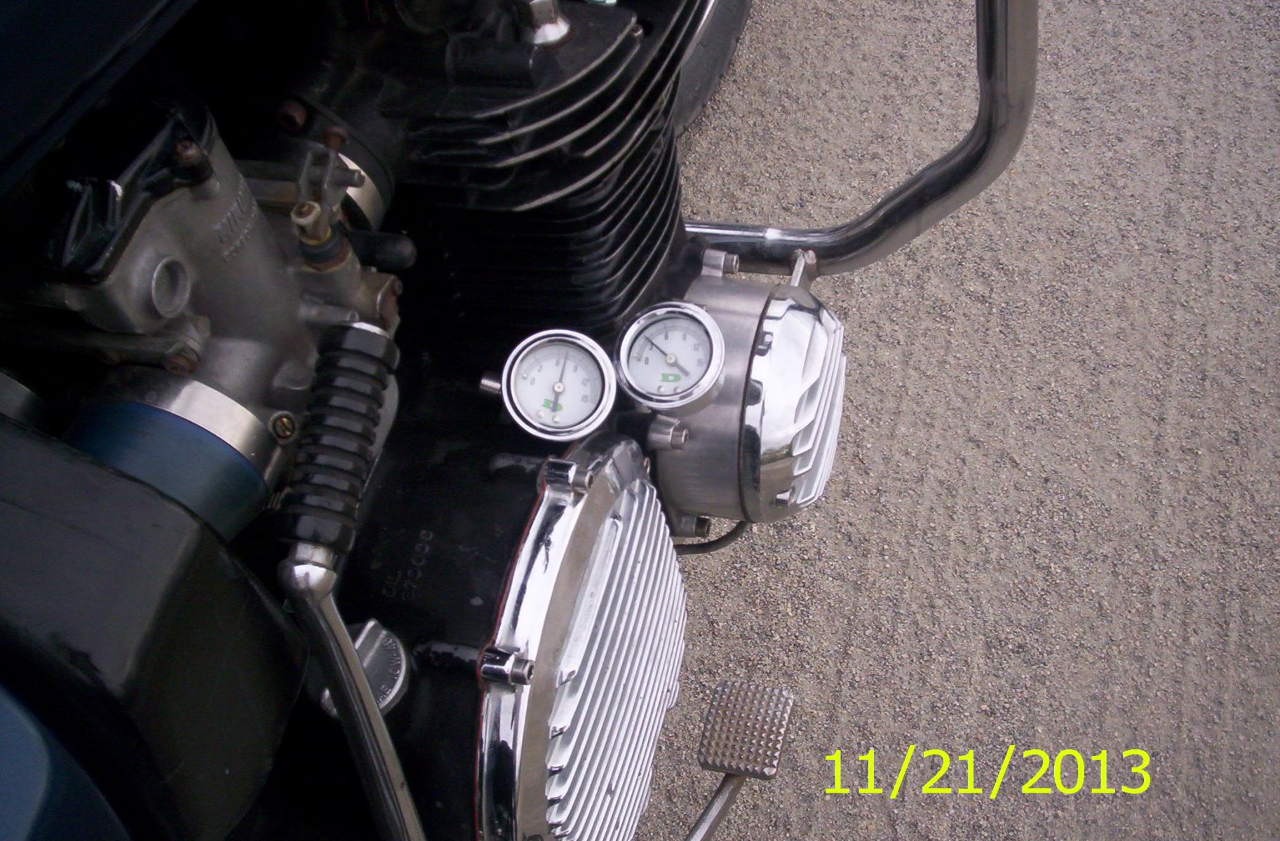

Mine is bad too. I put a pressure gauge on the test port above the Ignition housing.
FK it. You can't trust them.

Good looking gauges aren't they. Too bad they don't work.

Yes they look very nice. I want to thank you again for all your help.
