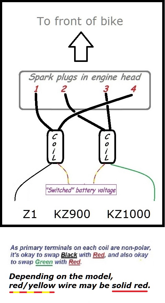

If not already done, would double-check connections of the spark plug wires from the ignition coils.
