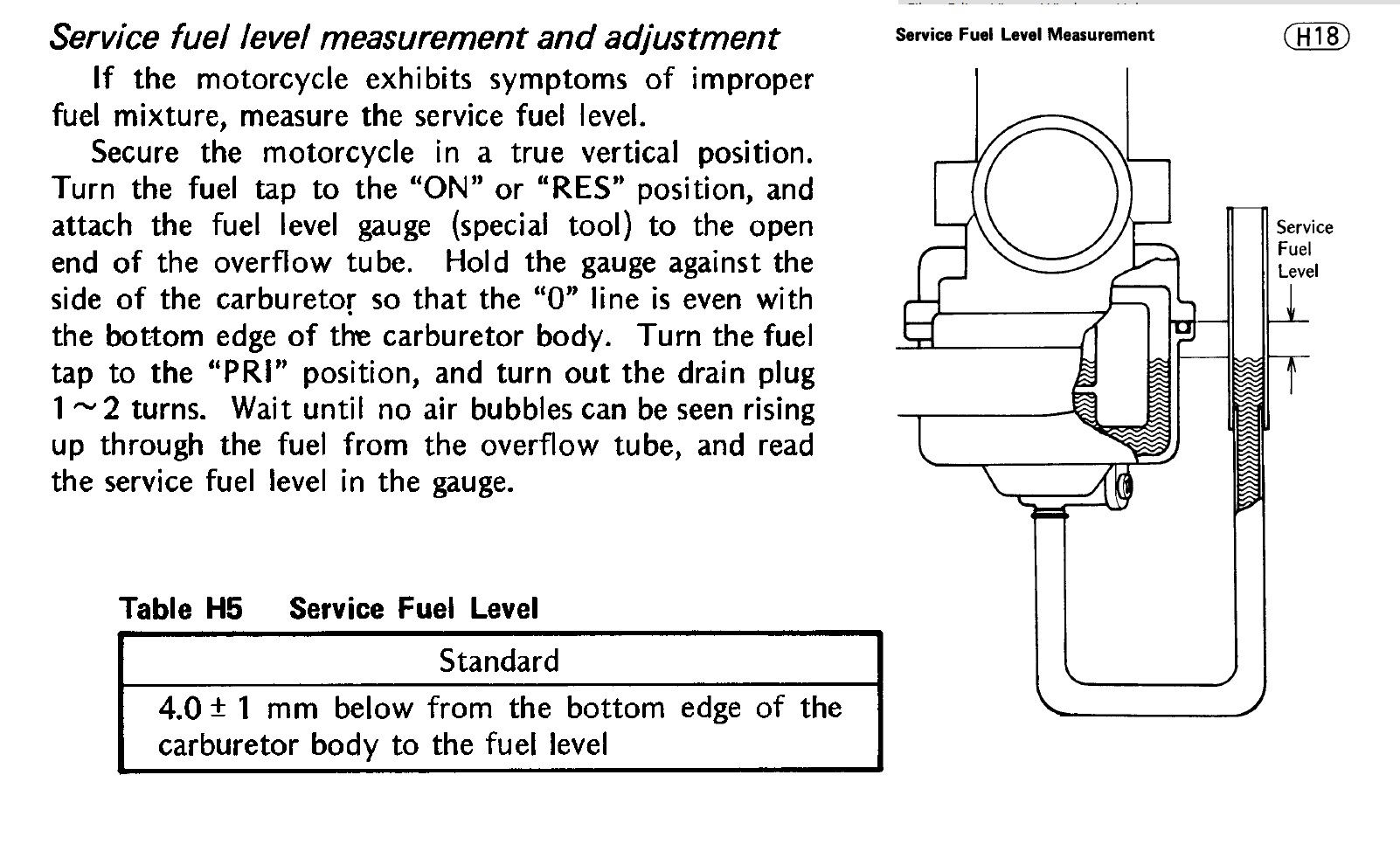

element303 wrote: ok i will lower it some more tomorrow. thank you!
As known, the objective is to set each carb fuel level to spec, not higher than spec, and not lower than spec.
Assuring that the fuel levels are within spec will rule out too high fuel levels as being the reason why brand new spark plugs are quickly soot-fouling.
It's not a good idea to set fuel levels below spec in order to achieve leaner running.
Good Fortune! :)

the way i set them is by having the carbs vertical and having the floaters line even with the line of the case in the moment the needle closes. i saw about the clear tube adjustment yesterday but never done it like that before.

If needed, to access a free downloadable KZ750 4-cyl service manual, use this link, and scroll down to "The Bible."
mbsween.bike-night.com/kz750l3/index.html
Here are some excerpts regarding the clear tube test, which is used to determine the so-called "service fuel level."
The dry-measurement for setting float heights is unreliable toward achieving the correct fuel level.
The clear tube test is reliable, because it visibly shows the actual true fuel level inside the carb bowl.
Good Fortune! :)

ok i will try that tomorrow. thank you very much!
