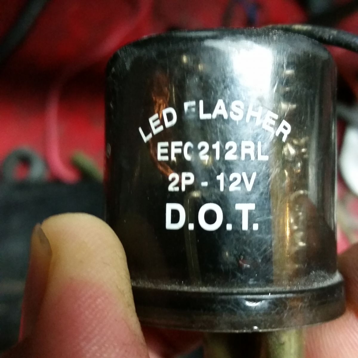

09 Jul 2014 20:06
#639520
jtpvg wrote: Yeah I just assumed the one one I had got for my other bike would work but I do have the original back turn signals for that bike. I believe I need one that is low load with a ground right?
I bought mine at O'reilly Auto parts. Brand is In Line, LED flasher P/N is EFC212RL 2P-12V
Jon
1977 KZ1000a1
Mesa, AZ
Phoenix Fighter Project
The following user(s) said Thank You: jtpvg

Re: The things that go blink blink :)
10 Jul 2014 13:01
#639619
they didnt have that at my oriellys but a guy at autozone just went through the same and sold me.what he used and it works. It has to be grounded but atleast they go blink blink
