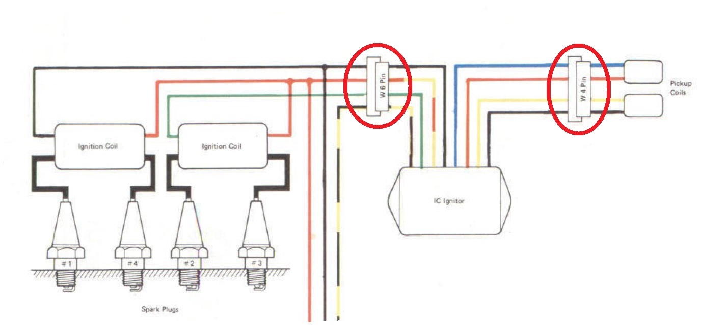

I just picked up an 83 kz1100 ltd which had been sitting for years. I rebuilt the carbs, and put in the parts that someone had removed. Cranked it and found that I have no spark from the coils on the right side. I checked for voltage to the coil and there is constant voltage to the coil that is not working. I thought the CDI was supposed to open and close the ground side to make the fire work. So does this sound like a bad CDI? The other coil has no constant ground and works fine. Thanks in advance.

These bikes have a IC Igniter, which give the ignition coils their grounds, sparking the plugs, so it's not a CDI as some people think it is. I'll give you some places to test:
Ohm Checking Pickup(Pulsing) Coils
The pickup coils on the Kawasaki’s with the factory supplied electronic ignition can sometimes fail or become intermittent due to heat and vibration.
1.Trace back from where the pick up coils are mounted,(under a right side CD sized cover) locate and disconnect a small 4 pin connector. Using a multi-meter set on OHMS and range of X 100 check between the BLUE and BLACK wires(#1 and #4 sparkplug wires) for between 360- 540 OHMS.
2.For #2 and #3 sparkplugs the wire colors will be YELLOW and RED, again 360-540 OHMS.
3.If the pickup coils are suspect of failing due to heat, they can be stressed using a hair dryer without the need of the engine running.
4.A replacement set of pickup coils might be obtained from a dealer who serviced the police Kawasaki’s.
5. If replacement pickup coils are not available, your next choice would be to order a Dyna “S” electronic ignition system from www.z1enterprises.com It replaces the IC igniter with a smaller module located where the mechanical ignition advancer was mounted.
6.Checking with Kawasaki.com website has determined that the Pick up(pulsing) coils are available . The pulsing coil # is 59026-1133 and replaces the older # 1002, 1012 which were used from the MKII motors until the 2005 P24.

Kawasaki Ignition Coil Primary And Secondary Wiring
Ignition coils on the 80’s Kz1000,Kz1100’s and Gpz1100’s are wired the same, that is as you sit on the bike, the LEFT ignition coil primary(small wires) are two wires, RED and BLACK. The secondary (or sparkplug wires) go to #1 and #4 sparkplugs(your primary wiring may be different). NOTE, the 550’s,650’s,700’s & 750’s are backwards to what is listed for the bigger 4’s.
The cylinders are numbered left to right as you sit on the seat; #1,#2,#3, and #4.
For the RIGHT ignition coil, the primary wires, again are two wires, RED and GREEN, with the secondary going to #2 and #3.
The RED wire gets it’s voltage from the run/stop switch on the right handlebar switch pod. Your primary wiring may have a different color.
The BLACK and GREEN wires connect to the IC Igniter(if the bike has the Kawasaki supplied electronic ignition) it actually gives the coils their grounds to fire the sparkplugs.
Primary(small wires) may be 3-4 ohms, but the secondary(sparkplug wire side) could be 14 K (14000) ohms.
The sparkplug caps should read 5K OHMS(5000), any higher, or a reading of infinity means new caps should be ordered.
To stress the ignition coils, take a hair dryer, heat the coils and see if the ohm readings change from cold to hot . If they do, it’s time to buy new coils.
Keep in mind, the wiring is reversed for the 550’s, 650‘s, 700’s, and 750‘s, that is the RIGHT coil primary will be two wires, RED and BLACK with the secondary(sparkplugs) going to #1 and #4.
The LEFT coils primary wiring would be again two wires, RED and GREEN, with the secondary(sparkplugs) going to #2 and #3.
These engines have what is known as a “Wasted Spark” that is, a sparkplug will fire during an exhaust stroke. It does no damage and many other motorcycle engines have this design.

- MFolks
Less
More
- Posts: 6650
- Thank you received: 540
07 May 2014 11:12 #631677
by MFolks
1982 GPZ1100 B2
Replied by MFolks on topic Power at Ignition Coil KZ1100
Help With Igniter
Loudhvx from www.kzrider wrote:
I still have the rough HEI prototype in my bike. It's working fine after a few thousand miles. Actually it seems better than the stock ignitor. The HEI modules have a better input filter and better output characteristics. The stock ignitor sometimes gets false triggers that cause an occasional missfire at idle, nothing major, you'd probably never notice it until you directly compare it with one that doesn't misfire.
Your next step is to swap the pickup wires to determine if the loss is in the ignitor or the pickups. It's very important to swap the right wires here. Swap yellow with black. And swap red with blue. (Use jumpers so you don't lose the orientation of the connector. In other words don't actually take the wires out of the connectors.) See if this changes where the spark is. If the spark moves to the other coil, then it is the pickup (or it's wiring) that is bad. If the spark stays on the same coil, then it's the ignitor.
The black and blue pickup wires are for one pickup, and red and yellow are for another. Just ohm out the pairs. They should be around 450 ohms. Wiggle the wires and the pickups to see if you ever lose continuity on the pickups. (Obviously the pickup connector needs to be disconnected from the ignitor.)
In your case, it will be the red and yellow wire that are suspect (if it's not the ignitor). They control #2 and #3 cylinders. If you lose continuity determine if its a wire or the pickup itself. Check any point where the wiring is bent. Look for bumps in the insulation and wiggle them while the ohm meter is connected. If the ohm meter moves, pull on the wire to see if you can stretch the bump. This indicates the wire may be broken inside the insulation. When the wire breaks internally and the insulation is in tact, it creates a small bump in the wire. If the wires look fine, with no bumps, and no losses in continuity, it's most likely the pickup itself. To be sure you need to get two really small, sharp pins. Sewing needles are too think. The pins that come on new dress shirts work good. Insert them into the wire insulation right where the wires go into the pickups. One for red, and one for yellow. Then connect the ohm meter to the pins. If you have no continuity, the pickup is bad. Luckily pickups are cheap.
1982 GPZ1100 B2

Thanks, that is a lot of great help. I started off by ohming out the pick up coils. They were reading about 400 ohms each so I guess that means they are good. I put the harnesses back together and swapped the ground wires on the ignition coils and the coil that was not working made a spark so that shows that the ignition coil is good. I put everything back the way it was and still no spark. So I will try cleaning all terminals next. But not to jump the gun, so it seems the pickup coils are good, ignition coils are good, so the only thing in between would be the ICI unit right? I checked the wire going from the ICI harness to the coil and it is not shorted or grounded. I still have constant voltage at the ignition coil.

With the ignition switch on, and the run/stop switch in run, you should be able to produce a spark, by moving a thin screwdriver in front of the pick up(either one), also the sparkplug caps have 5000 ohm resistor that can go bad from heat, age & vibration. New ones can be bought at
or any Japanese motorcycle shop. Before installing new caps, cut about 3/16"-1/4" off the end & install the new caps.
1982 GPZ1100 B2

I tried the wire jump on the pickup coils like mentioned and no spark to the plug on right coil. when I swap the ground wire on ignition coil I get a spark so that would indicate that the coil, cap, plug and wire is good. So that leaves the ICU right?

Your test would show that it is the igniter, (or the wiring from igniter to right coil (should be a green wire on the 1100)). It could also be the pickup with the yellow and red wires, or the connection from the pickup to the igniter.
If it is the igniter, you can make one cheap. It's in my signature.

If not already done, would first confirm connectivity of each wire into and out of the connectors on either side of the igniter.
