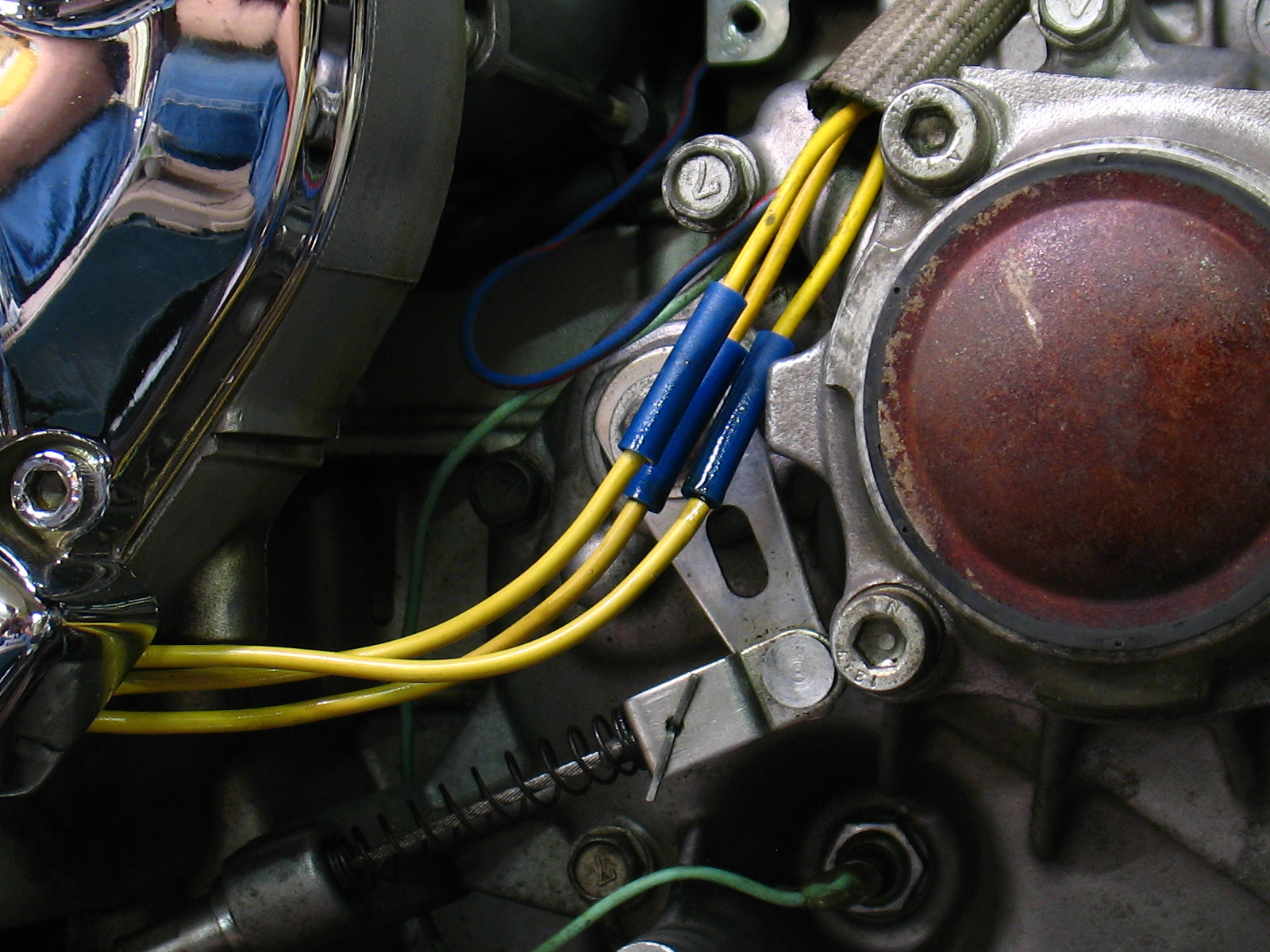

I'm baffled. Looking at the three bullet stator connections (yellow wires), there is oil on them. Could oil be getting pushed out between the yellow jackets and copper wires? I have no clue how it arrives there, since there is none on the outside of the wires. :huh:

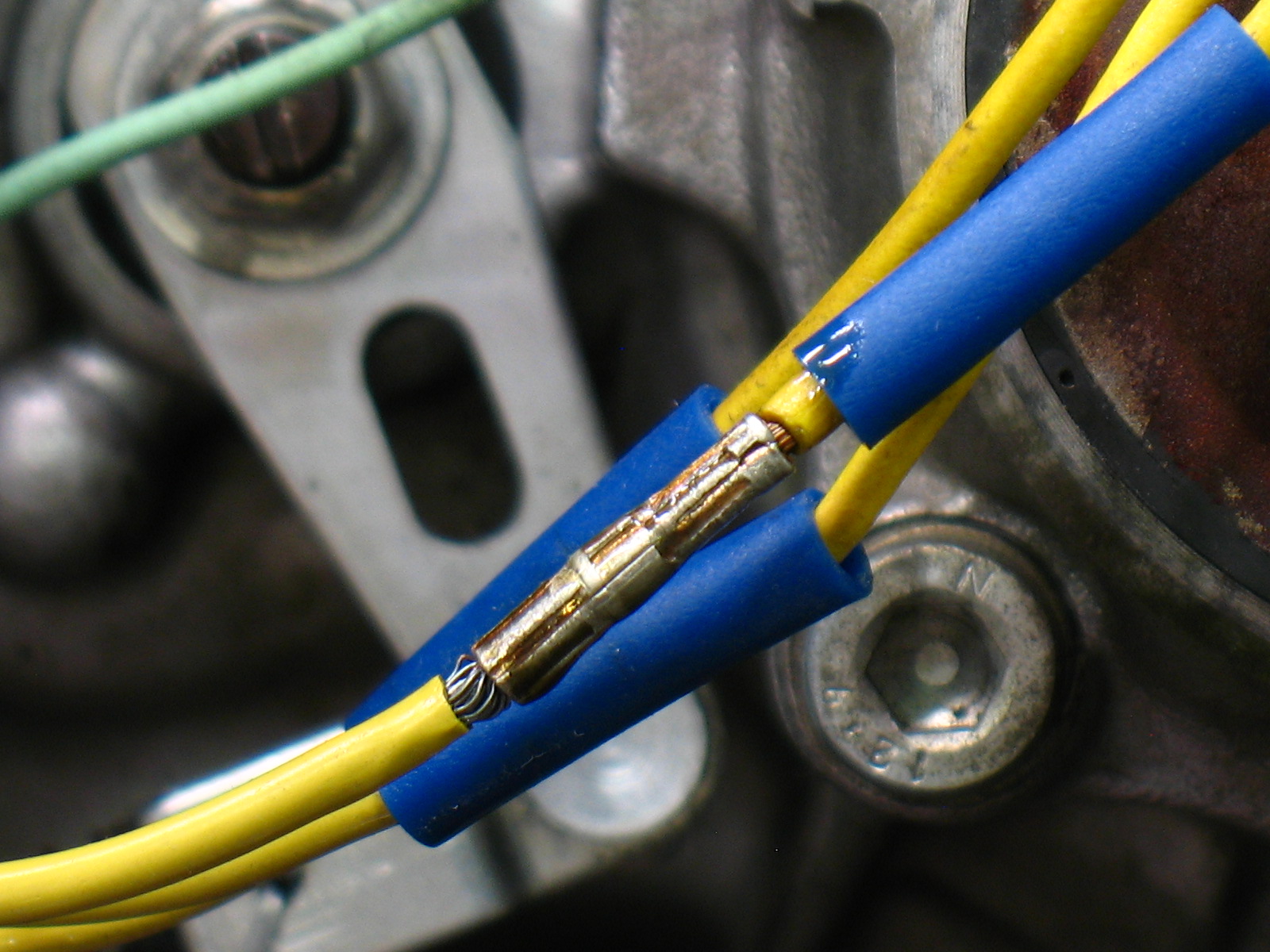

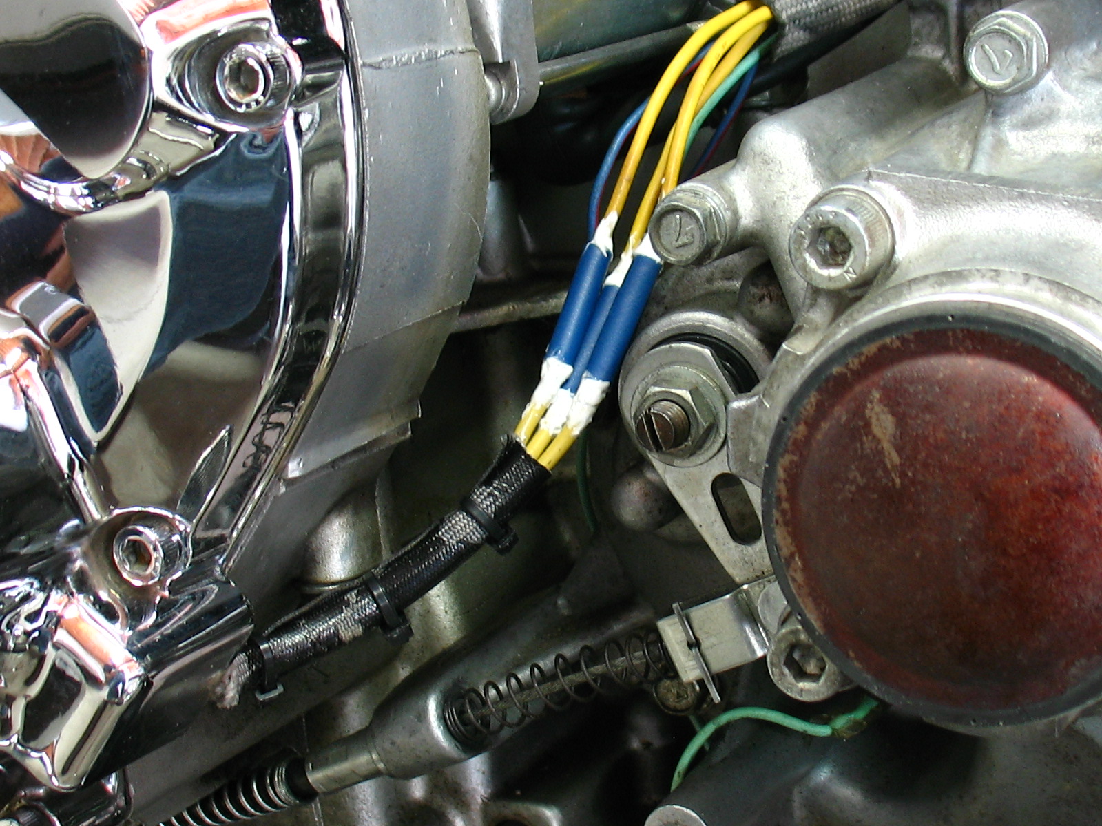

03 Jul 2015 22:06 - 04 Jul 2015 17:34koolaid_kid wrote: Physically impossible. I suggest you continue to look elsewhere.
A couple days ago, I finally sealed the wires with Three Bond 1211 after replacing the bullets with crimp connectors.
I discovered that oil had in-fact been seeping out between the copper wires, and rubber yellow-sheaths. :ohmy:
Believing it impossible, I've been wiping up oil for months...and finally had enough of it. Sorry.
NO LEAKS NOW!!!
1982 KZ1100-A2

That is one of those jobs I expect on old bikes now, the bullet connectors get heat baked and brittle and it is such an easy job to sort out. Your solder and heat shrink seems better than insulated bullets there.
