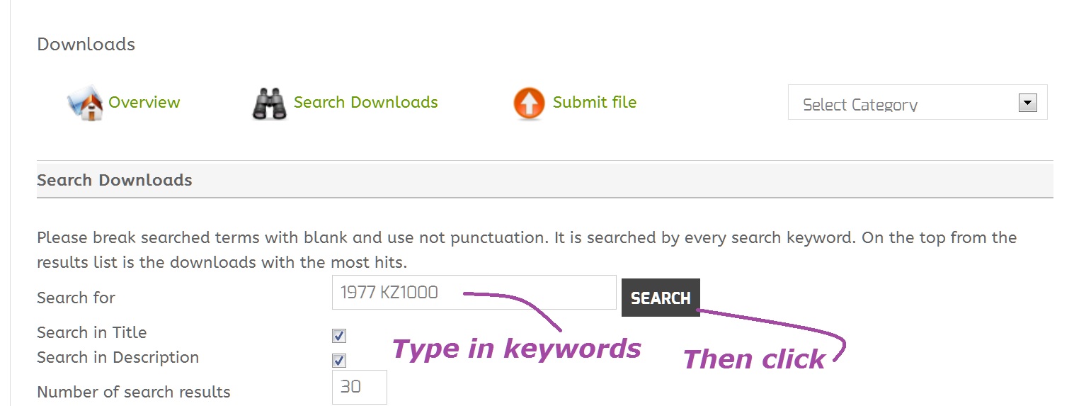

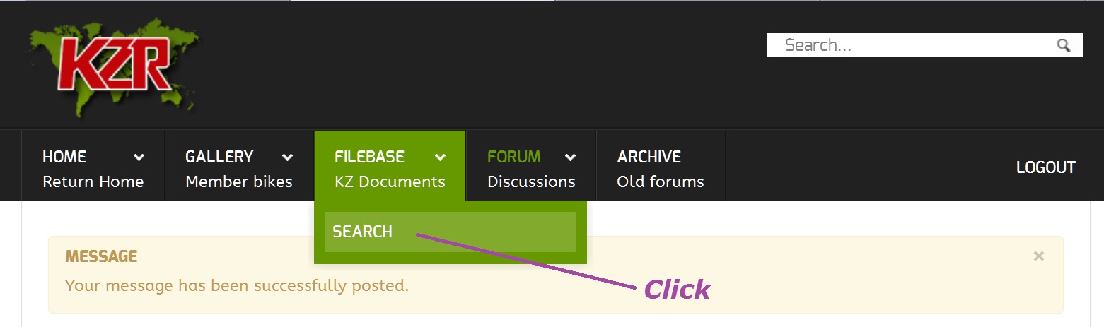

May search in KZr FILEBASE for whatever model or subject, to produce links to various topics, such as wiring diagram for a specific model.
Which produces a list of links.
