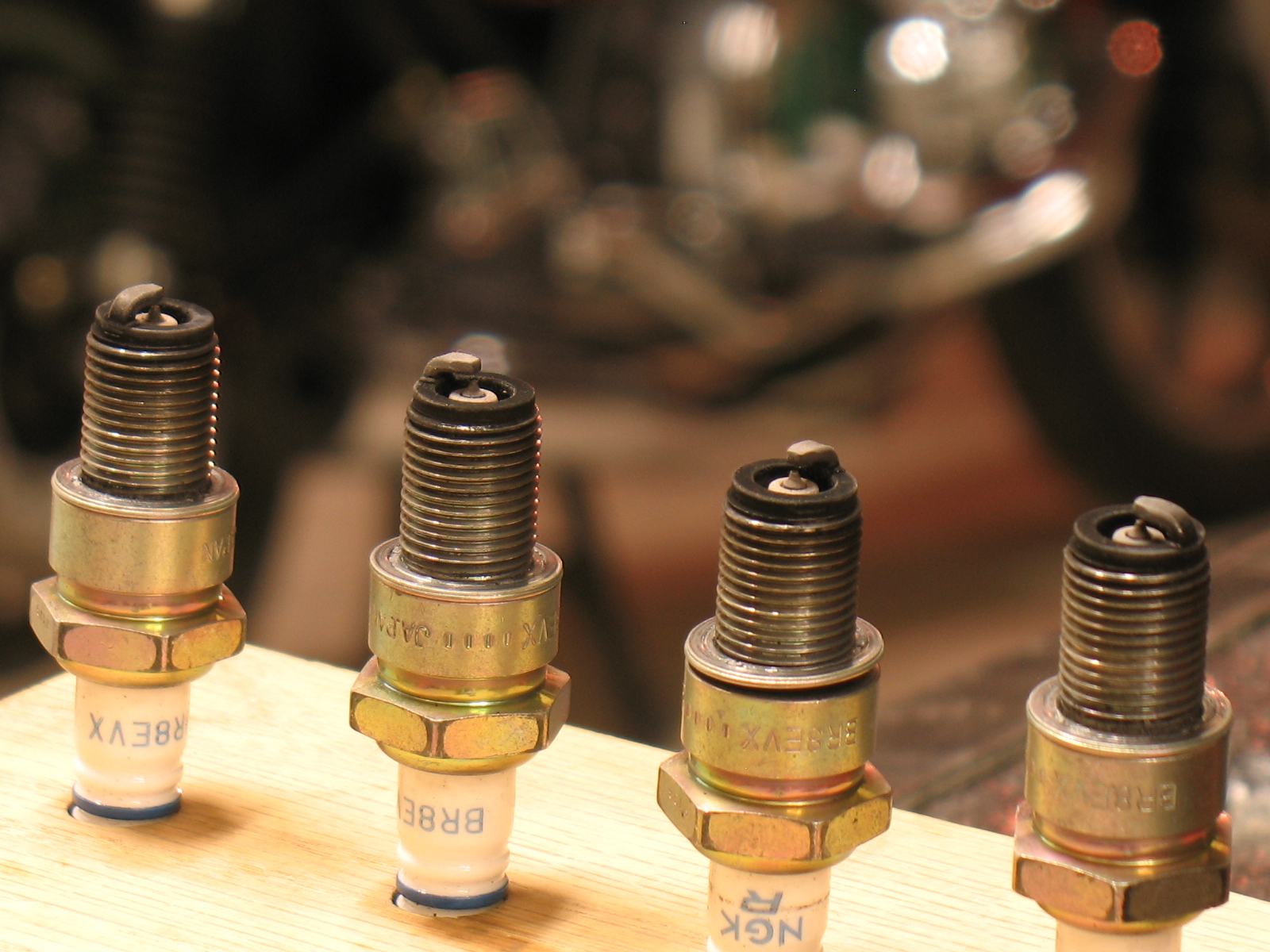

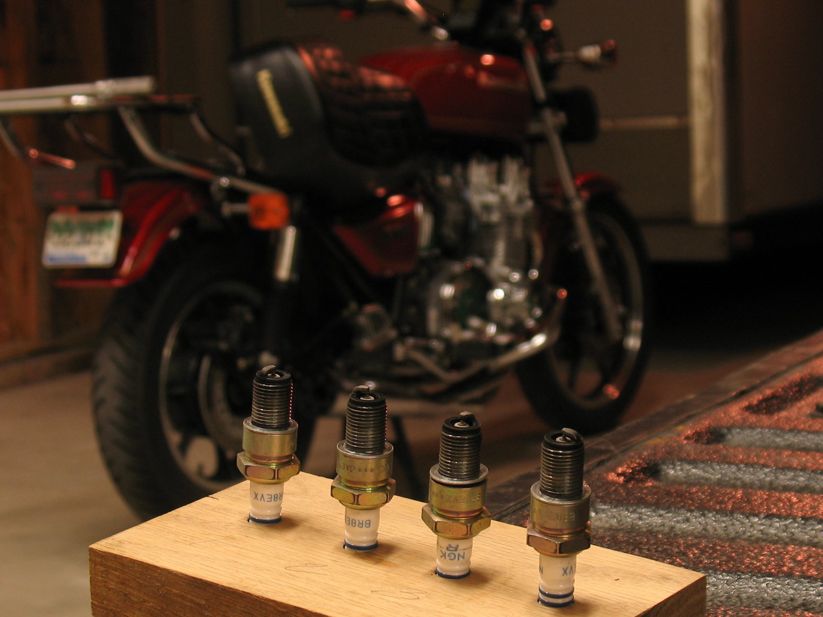

Just put in a new battery, and took it out for a spin. My headlight is brighter, and the voltage reads a lot better, I think. I didn't do any electrical testing on it myself, but judging how well she fired up after the ride, it may be alright.
I shot the SPARK PLUG pics after the ride. Does the color look acceptable on the plug? It seems much more consistent accross the set now, than it did with the old battery.
See below for closeup pic replacement.

Resistive plugs for your model, that correct....?
For now, look fine where non soot/carbon on the insulator, strap 50/50 hard to say, carbon on base ring...
Need more than a ride around the block.... Take her for a nice 50-100 mile run then compare...

Why using R plugs?
R plugs may in this instance be causing weaker (i.e., less complete) combustion and therefore darker plugs.
Would replace plugs with brand new B8ES (non-R) and repeat the plug reading after a nice long test ride.

09 May 2013 09:36 - 09 May 2013 10:00Heres a better closeup pic
:blink: There is no other resistor component in the setup.
Otherwise, a resistor wire set, OR resistor caps would be needed, if I'm not mistaken. I currently prefer using solid-core wires.
If run with no resistance, then what about the poor people's pacemakers or cell-phones? The exhaust setup already makes every obnoxious Harley seem quiet.

Correct. Your digital volt meter may get whacky with no resistor element as well.
Plugs look ok, if they've been in the bike for some time. Otherwise, could be a tad rich (as OMR's photo guide says), but not too bad.

"There is no other resistor component in the setup. "... No, that isn't correct.
Spark plug wires themselves are designed with resistance/inductive properties! You can have a couple ohms up to a couple thousand ohms pending designs...
This is one of the main reasons a single universal plug wire set (other than lengths & boots) won't work for all vehicles/ignition sets.
If your kawi model does not call for resistive "R" rated plugs, you'd be limiting the voltage/current (Ohms Law) for your ignition spark....
