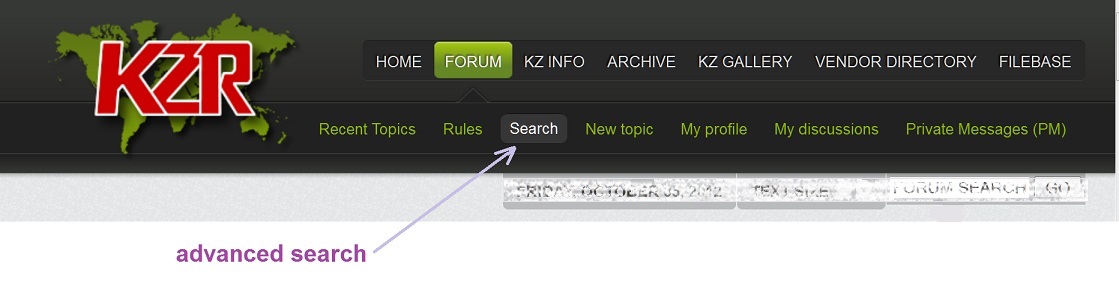

To locate existing threads with info about the fuel pump --
Could do an advanced search
Keywords Z1 Classic Fuel Pump
Under Any date
Should produce links to several pages of threads.
www.kzrider.com/forum/advsearch?q=Z1+Cla...te=all&childforums=1
And another advanced search
Keywords KZ1000G Fuel Pump
Under Any date
www.kzrider.com/forum/advsearch?q=KZ1000...ildforums=1&start=10
Other keyword variations such as fuel pump may provide additional threads with helpful information.
