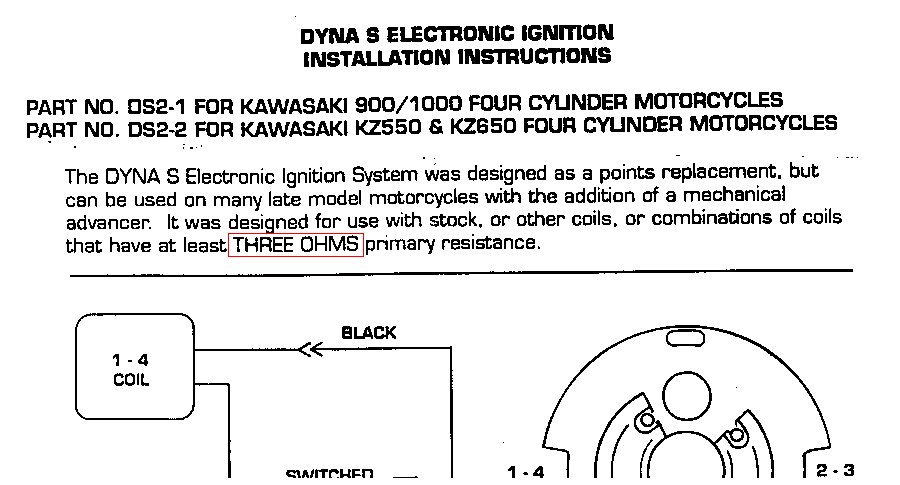

13 Jan 2013 00:34 #567076 by loudhvx
Replied by loudhvx on topic Dyna S Ignition Coil Compatability
Stock electronic ignition from Kawasaki uses 2.3-ohm coils, which are too low for the Dyna S.
The stock, points coils are 4.0 ohm, which work fine with the Dyna S.
Page one of the instructions:
You can't use the mini coils on ignitions with fixed dwell. They require ignitions with variable dwell angle so the coils don't overheat.
