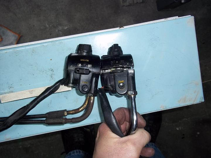

If It is a 76 KZ900. Originally it had an on and off switch.
Somewhere down the line, the switch housing was switched out with a 77-78-79 switch block.
The case was the same, they just did not put the knob in, they blocked it off with a liitle black piece. Here is a picture of 2 similar.

Mine is like the one on the right, with the block out plate. Still trying to figure out why it will turn over but wont start.
