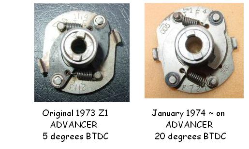

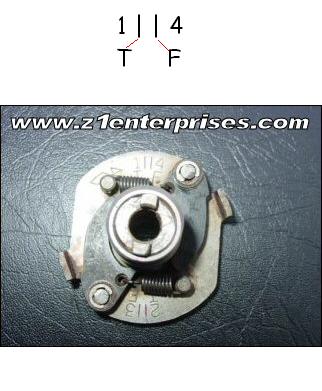

FWIW, per FSM, the stock timing advancer (Frame No. Z1F-32818~) is 20° B.T.D.C. @ 1,450 ± 100 rpm,
which advances to 40° B.T.D.C. @ 2,350 ± 100 rpm.
Earlier models are 5° B.T.D.C. @ 1,500 ± 100 rpm,
which advances to 40° B.T.D.C. @ 3,000 ± 100 rpm.

Paton thanks for the pictures and info 40 and curve 4 seems as close as possible will keep you posted.
