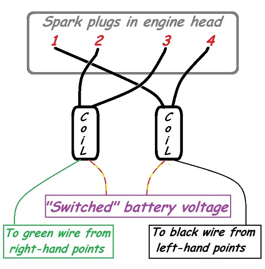

Would assure ignition coils are wired correctly.

For about an hour ago I went to my local dealer to buy new spark plugs. Came back home and installed the spark plugs. Pushed the starter button, and there was no go.. I was literally about to set the whole bike on fire of frustration, but then I came to my senses and dismantled the tank to start on the valves.. Suddenly I realized that the "Switched battery voltage" wire to the right side coil was off... Then I felt something very likely to hope! I hooked the tank up again and pushed the starter button. The bike started to ignite!!!!! Did not start though, even though it sounded like it was about to... I was able to push the starter for about 6-7 seconds, and then the battery suddenly died..... "%#%&!!!%#4&!!!!!!!!
So now I have hooked up the battery to the charger, and will give it a go again about an hour. Hopefully it will start then....
So my question is... Even though I will get an answer to this the next hour... Do these bikes need full battery voltage to be able to start? Im very impatience, so an hour seems like a year....
