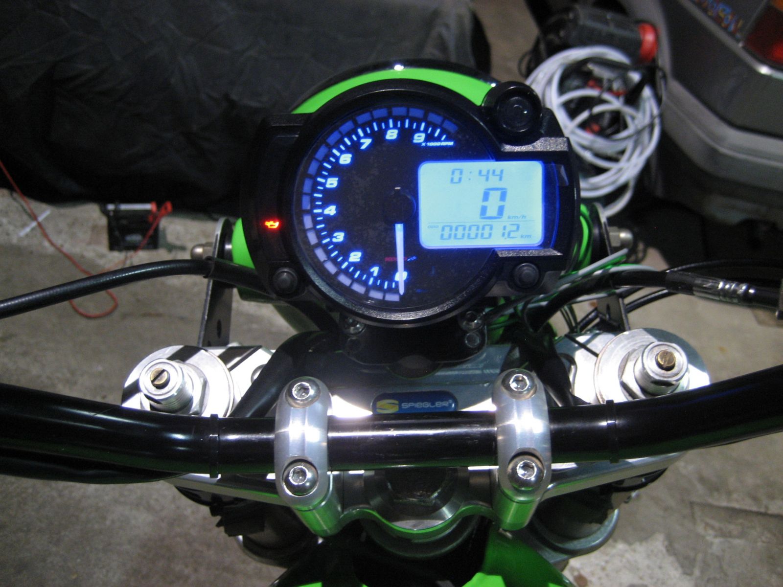

The Koso RX1N tach on my 82 GpZ1100 has bounced around since the day I put it on. I have tried every tach signal filter and home grown solution to no avail, it still bounces. I have talked to Pierre at tech services for Koso for a long time trying to get this fixed. He had me send the gauge back to Koso on their dime for testing. Even though my gauge tested OK they sent me a replacement gauge. The problem is still there. I have done the following. At this time Koso does not have a solution for me.

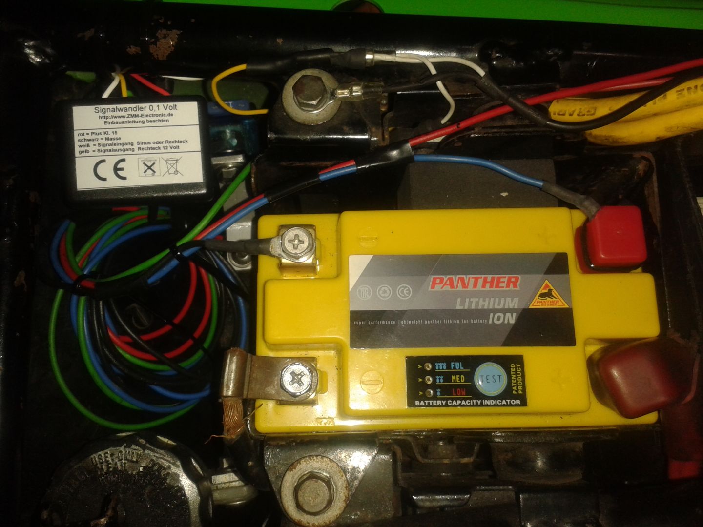

I try the same on my KOSO RX2N+ GP Style connected to one of the alternator wires. No cure, the same bouncing effect
as on all other low pas filter, resistors, diodes, condenser circuit boards i made.
Here is my solution to eleminate the bouncing effect:
kzrider.com/forum/4-electrical/607690-de...eter?start=20#784802

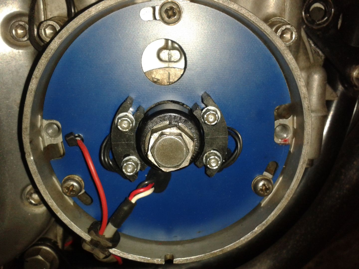

I soldered a wire to one of the Dyna pick-ups on the backside.
Output is 0,50 - 0,80 Volts square wave with an oscilloscope detected.

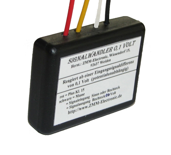

The converter, (min. 0,10 Volt input square/sinus/triangular signal = ABS sensor), transforms the signal to a 12 Volt square signal,perfect for my KOSO RX2N+
