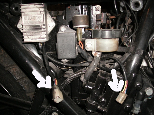

I am still not getting anything. I bought a new meter so I can restart my quest.
I have tested the coils and they were 2.0 and 2.2 ohms
I tested the secondary wires and they are both roughly 20,000 ohms
Now I need someone to explain to me exactly how to test the igniter and anything else I might need to check. I unplugged the connector to the igniter. I have attached a picture for reference. What connections get checked for what and how much/many (ohms) am I looking for?
I have a manual for the J model but it is confusing to say the least.
